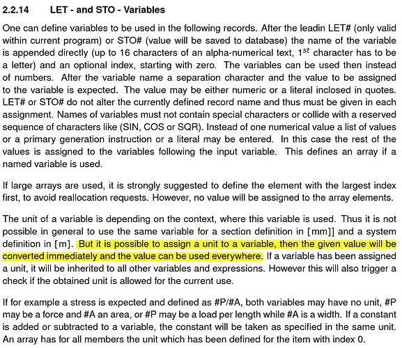

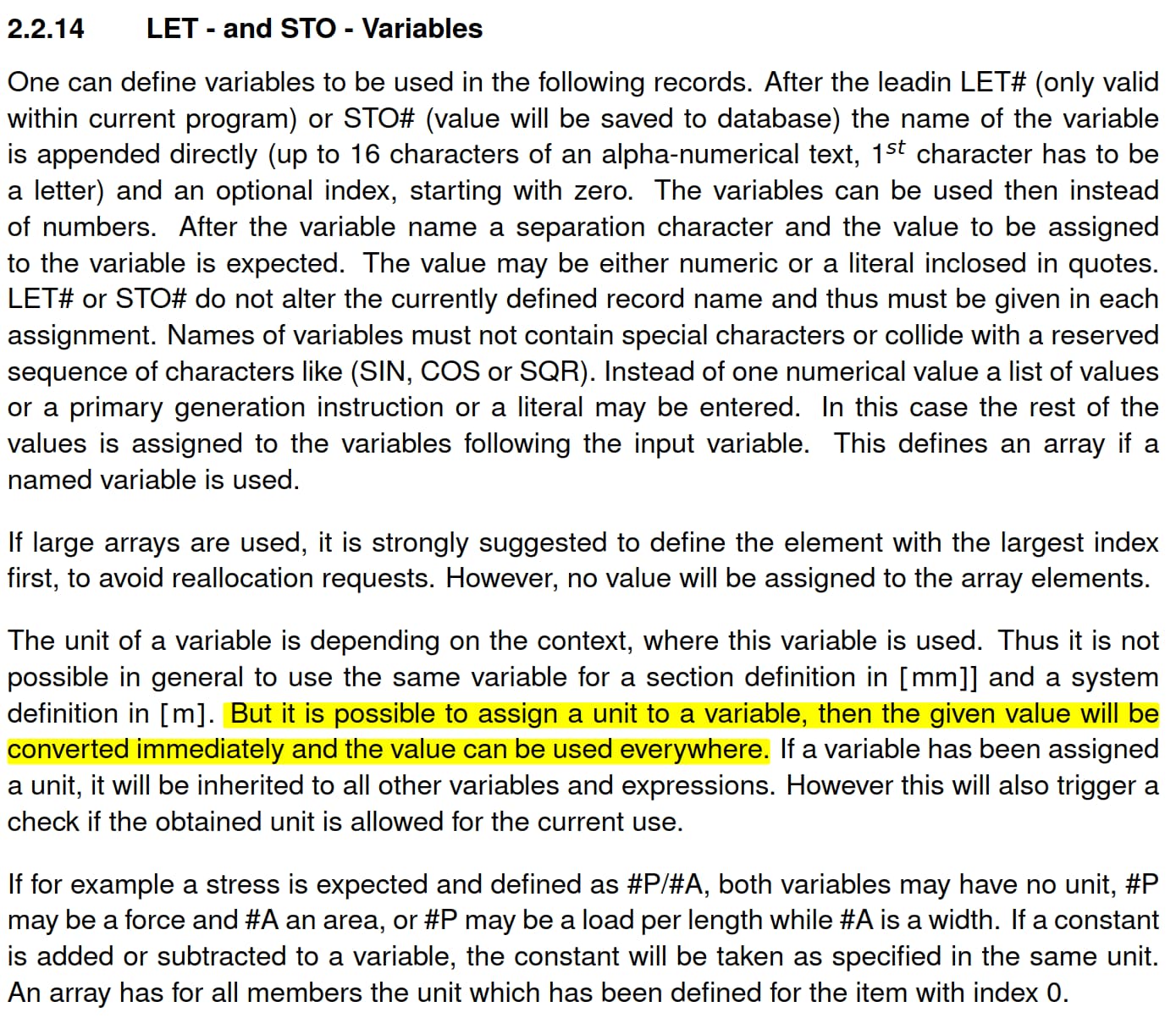

The conversionbehaviour is intended, see the sofistik-manual:
(I don’t like it, because sometimes it causes trouble;
for instance the unrequested conversion of imperial units to SI Einheiten / Unit)
