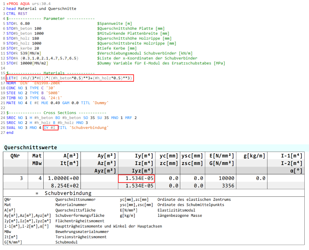

I have defined a variable #I in Teddy. This variable is intended to have the unit m⁴. The following parameters are used:
#k [MN/m]
#E [MN/m²]
#h_beton
#h_holz
As you can see, I have not specified any units for #h_beton and #h_holz. However, these are supposed to have the unit mm. For this, these variables should actually be converted to m within the calculation.
Strangely enough, Sofistik performs this conversion automatically and converts #h_beton and #h_holz from mm to m. I would like to know why Teddy does this and how I can gain more control over the unit conversion.

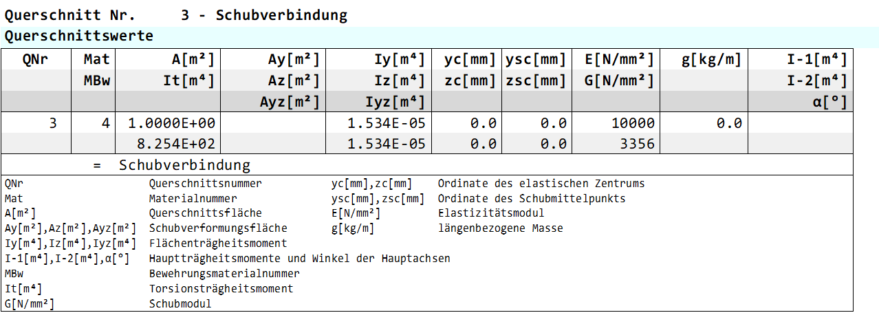

#I = (539/310000)*[(100*0.5/1000)^3+(1800.5/1000)^3)]=1,534 10^-5
→ as you can see the result in the report browser result from an intetrnal conversion of the parameters #h_beton and #h_holz from mm to m

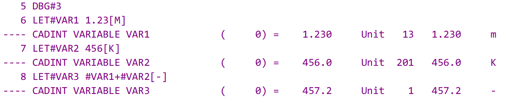

Another option is to assign the “unit” [without specification]:
let#var1 1.23[m]
let#var2 456[K]
let#var3 #var1+#var2[-] $ [-] means, that the value is without specification / unit-free
looks like this
