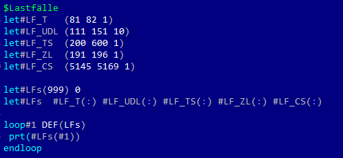

I think something like this should work:
Yes, this is solution that I was looking for. Thanks.
