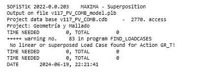

I am currently working on a precast bridge beams project for my master’s final project using Teddy. I have followed the Sofistik Bridge Design Training video series, but I am encountering an issue when attempting to perform the combinations with moving loads using MAXIMA.
I have attached my Teddy file for reference. Could you please assist me?

You’re overwriting the results.
First GR_T is saved at lc 100 and then GR_U is saved at the same position

There is an easy way to check before MAXIMA which load cases are assigned to which action / category with following SOFiLOAD run only for the output table of actions and assigned load cases
prog sofiload
head
echo act full
end

Oh my goodness, thank you all so much! With so many lines of code, I eventually got lost. I really appreciate all your help. Taking note of your advice, Sabine, thanks for the tip.
