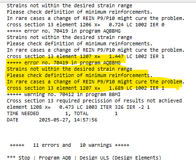

Hi, after running CSM Bridge Design (Beam) I’ve ran into this error. I’ve tried to change my reinforcement and also modify the teddy, but the error is still there. What can I do to fix this problem?

Hi all, the same error message appears for me. Any idea how to fix this error?

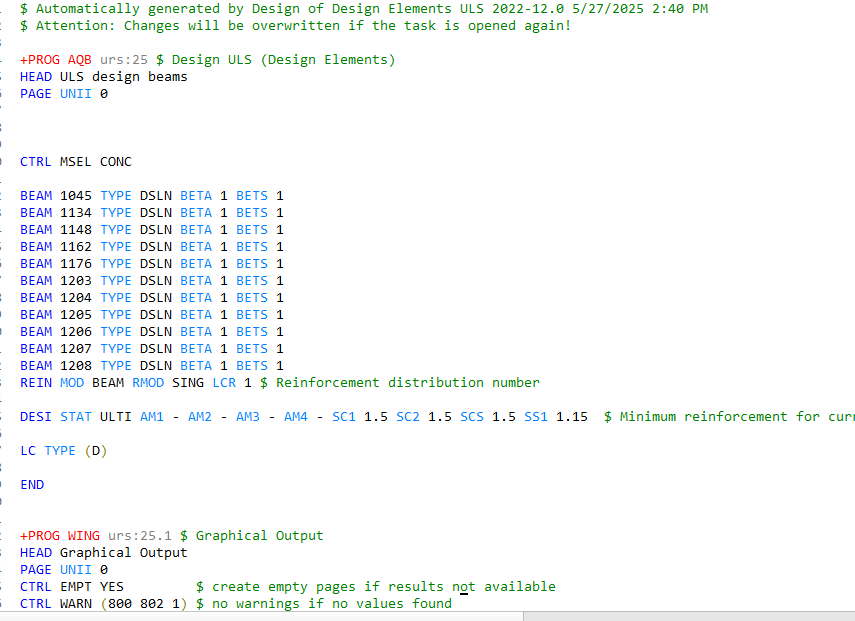

I changed the reinforcement layers in my cross - section. Do not put 2 layers of reinf. in same layer ( i am only regarding on layers which are on main bending side).
I was talking about changing you reinf. in cross section editor ( if you are using SOFiPLUS), because it uses that reinf. as minimum. Mby you can change parameter AM1 and try to ‘‘force’’ minimum reinf. for beams.
