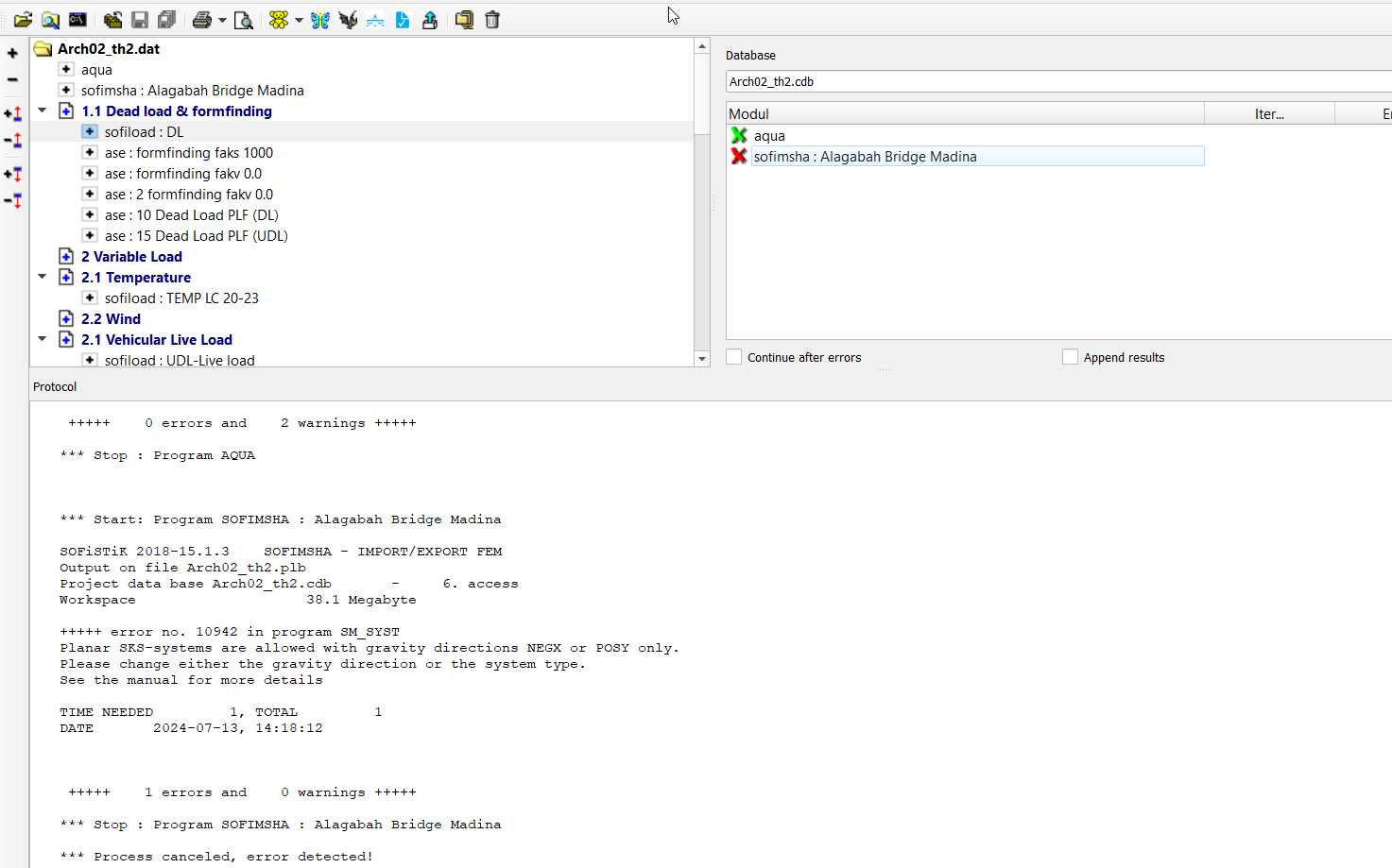

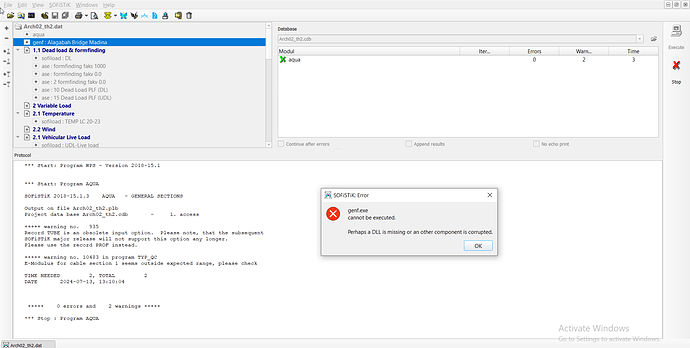

Hello Sofistik team,
Can any help me please to solve this problem with me?
I use SOFISTIK 2018 and when I run this teddy model (I think it is old version 2016), this error appears, and I want to solve it to continue the model run.
Thank you

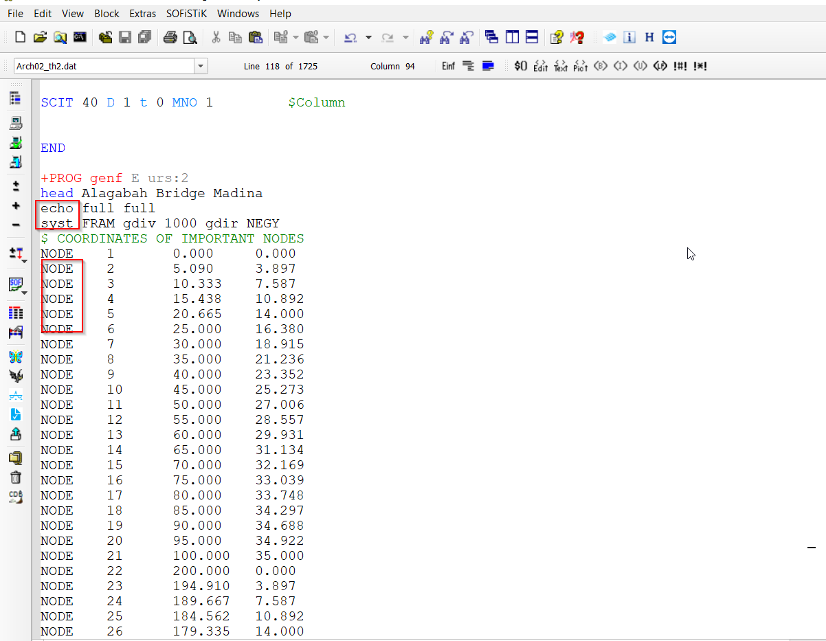

Also, it is my first time to see
+Prog genf.
What is this module and what is usage
for prog genf
ECHO is not in blue text
SYST is not in blue text
Node is not in blue

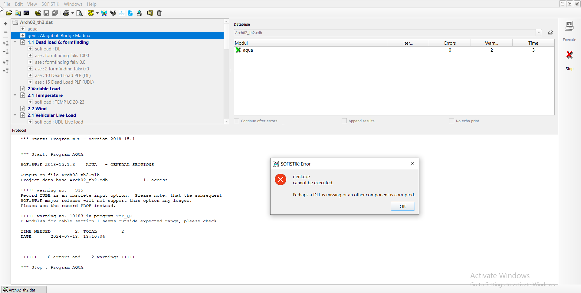

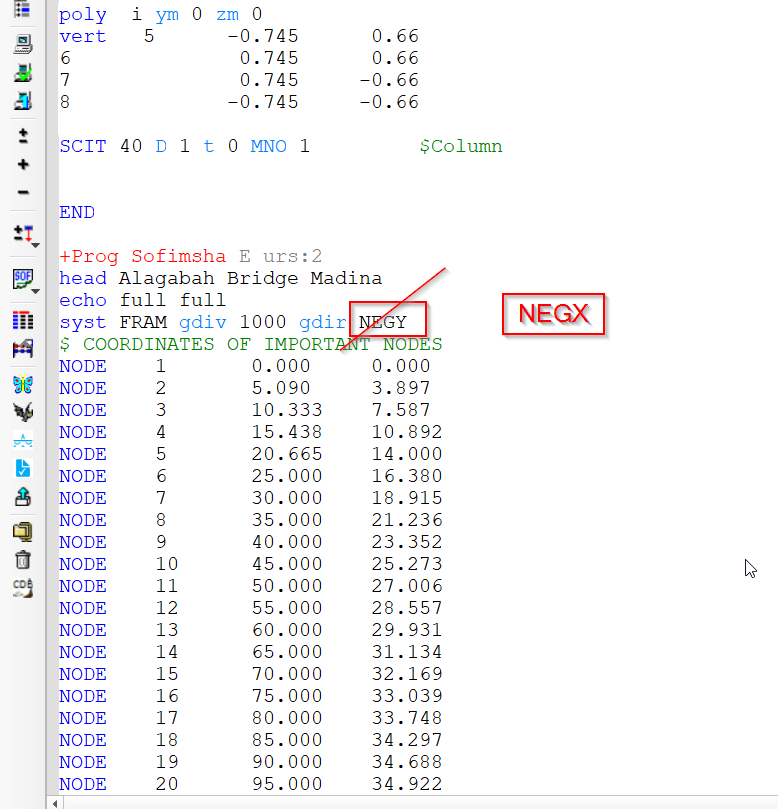

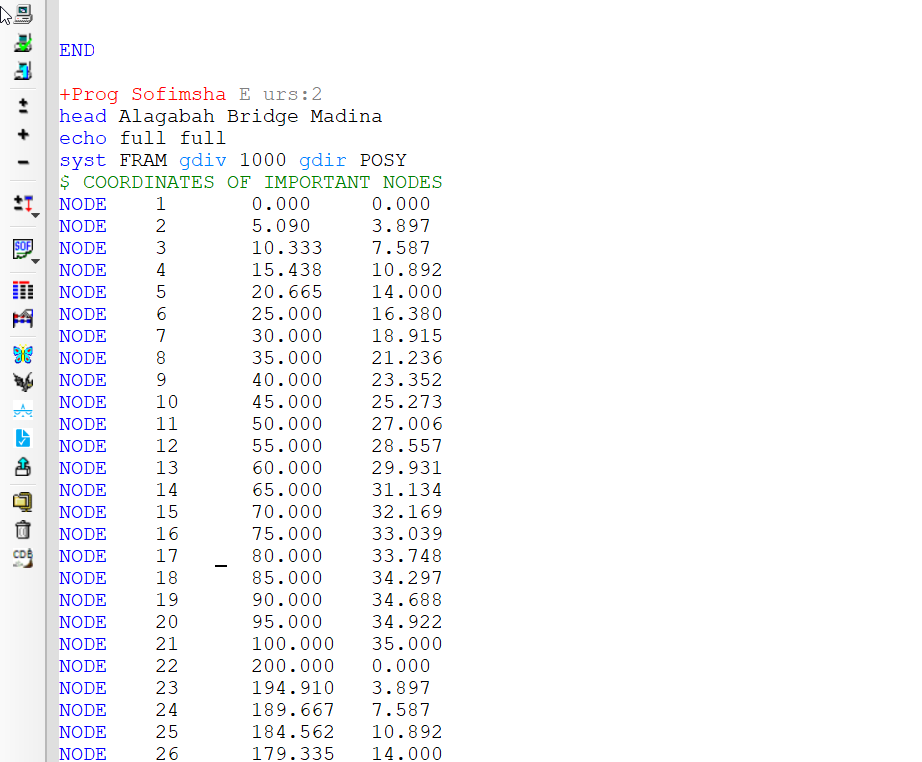

Try using +Prog Sofimsha instead of +Prog genf

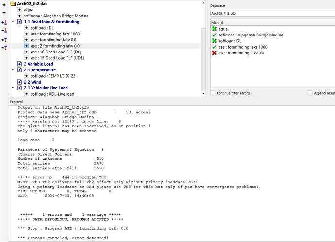

Hello sfr
When I do this, another error appears
It is correct to make this modification.

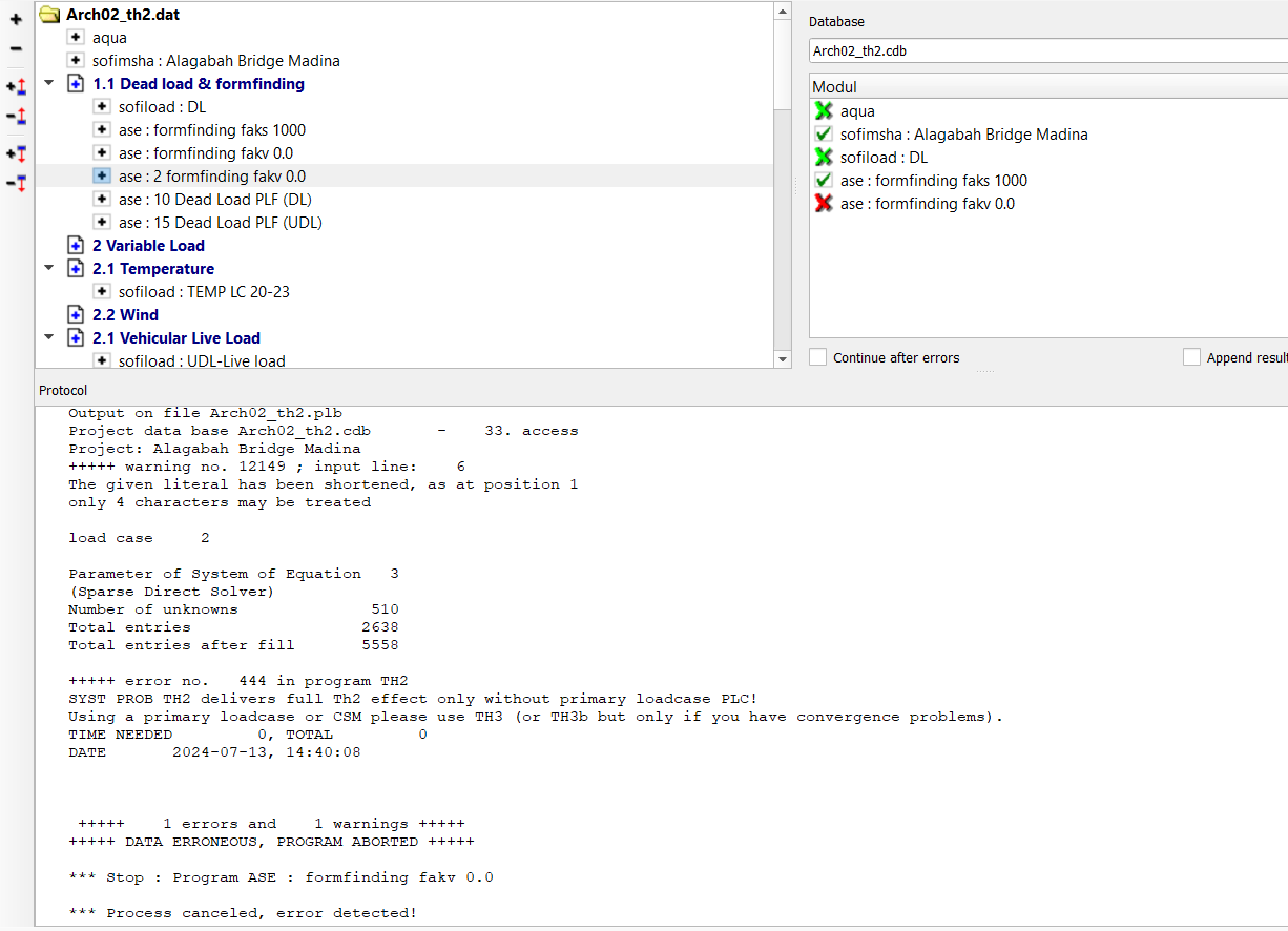

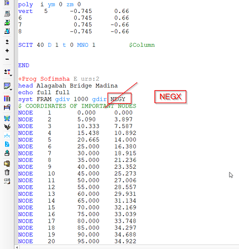

Here i use posy instead of NEGY, but another problem appears
  • Originally gravitational loads are directed in the negative y-direction
  • Negative y-direction not possible due to update
  • Changed to positive Y-direction
  • Structure is now upside down with respect to gravity
You need to flip the structure.
Put a minus sign in front of all the y coordinates of the nodes.
You’ll also have to do this with applied loads (if they’re applied by coordinates)
Also you probably need to change the direction of loads in the y-direction
