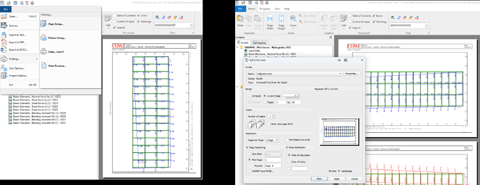

Hi I’m trying to rotate the entire page when using wingraf, but I have a hard time rotating anything other than the actual figure using SIZE URS/-URS. However, I want to rotate the entire page, which I can do manually in the viewer as shown here:
I would believe this setting should be available in Teddy so I can automate it?
unfortunately I think that the orientation of the page is saved in the printer settings, which Report Browser retrieves from the system when it opens a file.
It’s not so much of a “project option” as suggested in the drop-down menu. It’s quite much a system-wide setting:
  • If you change the orientation in the printing dialog, it changes them also in the project options
  • If you switch to another project, the orientation is kept
Is there a way to override this in the file sofistik.def?
