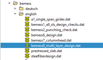

Hi
I think that you need to use layer design in that case. Since maximum reinforcement is not used in BEMESS otherwise:
In case of layer design you can assign the maximum reinforcement to all layers except the most inner one:
Take a look at the following teddy example:
