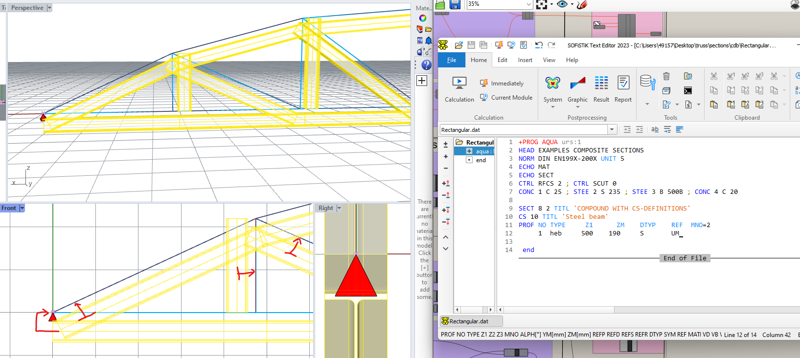

Hey everyone. i have implemented the cross section but i want it to be assigned in the middle of the web member of the I beam, but i can not seem to find a solution. As shown in the figure, i want all the web members to be moved to the geometry initially created.
Any ideas?
try using the alignment or offset tools in your software. You may need to manually adjust the coordinates to center it within the web member.
Try REF C.
