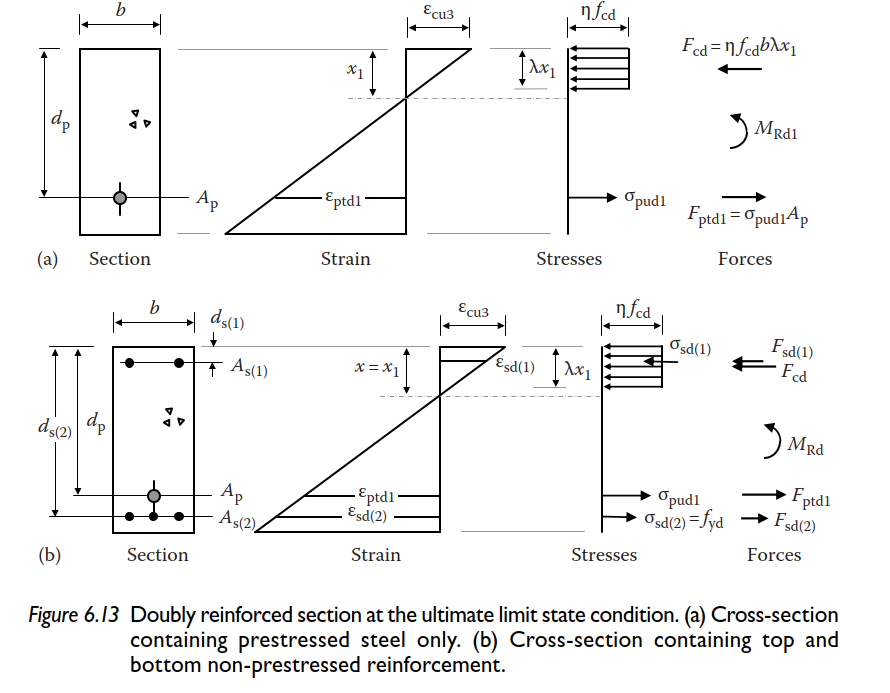

I’ve stumbled across this line in section 6.4.3 (Design of doubly reinforced cross section) which deals with the below figure:
“If the depth to the neutral axis in Figure 6.13b is greater than about 0.3d,
then the section may be considered to be non-ductile and the value of x
must be reduced. An appropriate value of x may be selected (say x = 0.3d).“
My question is: is there a way to check the depth of the neutral axis in Sofistik? Does Sofistik check the “0.3d” limit (or some other value - I’ve seen 0.45d being used as well) and adjust its design accordingly? Or is some other means followed in Sofistik’s design.
