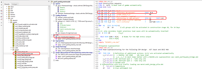

I have a prestressed cable tendon, and it is divided into 2 different construction stages, for example stage 10 I tension the cable to P1=1800kN, in stage 20 I continue to tension the cable to P2=2200kN, how can I do that? Do I have to create 2 cables tendon with different tension values, the same prestressing system, same geometry? Is there a direct way without using just 1 cable tendon?
Hi TungDo,
please see our standard TEDDY example
csm31_partial_prestress.dat csm31_partial_prestress.dat (24.8 KB)

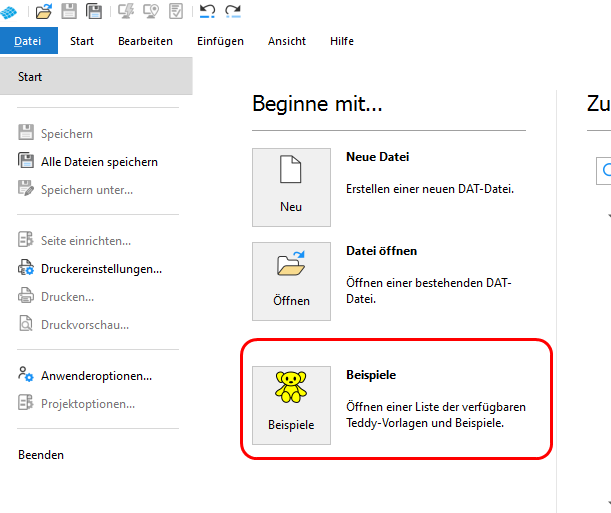

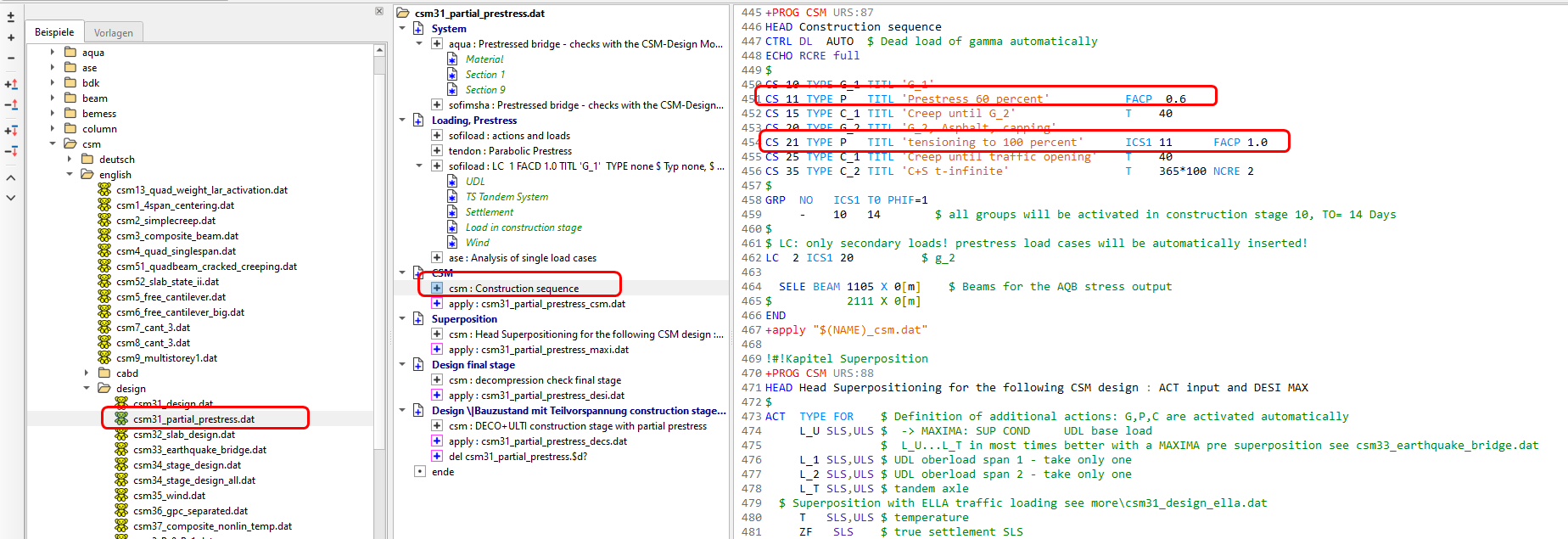

You will find this example via TEDDY Examples (see pictures below)
