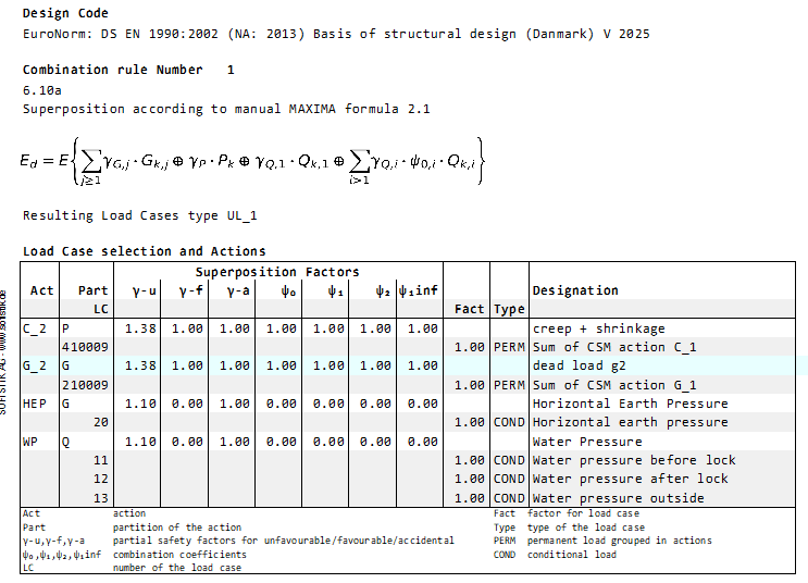

I’m trying to minimize the maxima output for a report. The only thing I actually want to see is this part:

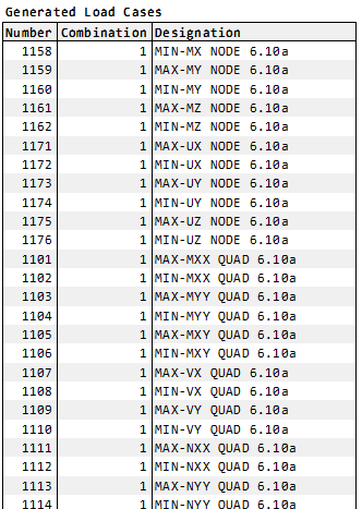

unfortunately, no matter how I try to combine the ECHO VAL xxx opt xxx syntax I keep getting the generated Load Cases table as well:
Is it in any way possible not to print this table and only get the general combination table?
in the current versions it is not possible to printout the tables of the combination rules and the table of the generated load cases separately. Here only ECHO TABS YES , FULL or NO are possible. YES or FULL have only an impact on which combination rules are printed (YES the used and FULL all available).
In the next Major Release 2026 (planned Juli 2025) the ECHO options of MAXIMA are modified. ECHO TABS is only for the tables of the combination rules. New is ECHO LC for the table of the generated load cases.
