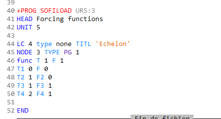

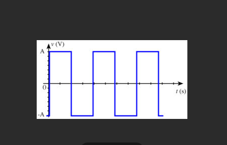

I would like to code a load function with Teddy. I can code a periodic function like sinus, but i want a square signal function to carry out a dynamic analysis. I think i should put some points from my function however i dont know how to do. I can join you an exemple of the type of function i want with my code.
Really thank you, if someone have an idea

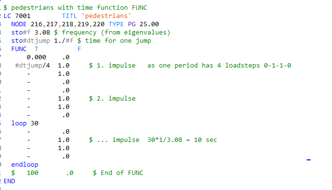

The input looks similar like
Simply make a small example and test it.
