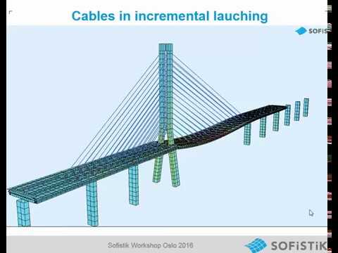

The same principles apply like with truss elements working in compression only, namely a non-linear analysis must be performed in order the non-linear properties to be used. Please also refer to the explanatory video in the folder below.
