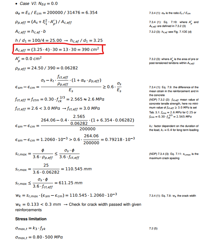

I’m studying Sofistik and checking reinforced concrete cross-sections. I’d like to ask about how to retrieve results from a report. Let’s take Benchmark Example No. 12 as an example.
Firstly, some results are missing, such as the Ac,eff, and As values ​​used to calculate pp,eff. Is there a way to find these values?

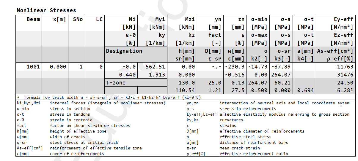

Secondly, how can I directly extract the values ​​from the report to Excel without manually copying them? I tried to open the results but i can only find the stress and strain of reinforcement.
