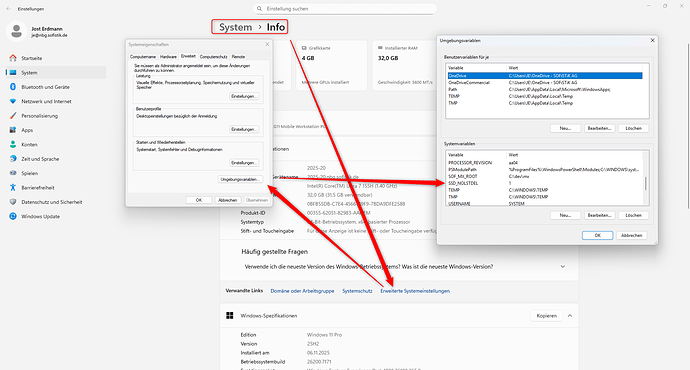

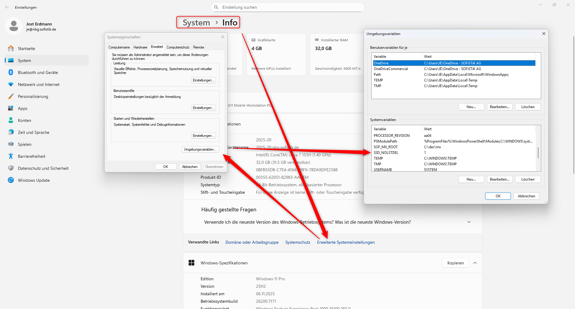

When calculating an SSD-task a pure text-file is created, it’s a file-type lst (list-file). But it’s deleted again because the content is only from that task.
To keep it you can define a system environment variable SSD_NOLSTDEL with value 1, see screenshot.
To save it you can define after each task a teddy-task with necessary commands
+sys ren old_name.lst new_name.lst
or
+sys ren old_name.lst new_name.txt
