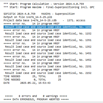

As the CSM Bridge design SSD tool work for road bridge I used teddy program to bridge design earlier it was showing _15.dat file doesnot exist error. Same error as _38.dat for CSM beam design. anyhow later it ran but now showing following error problem. Not getting how to locate source load which is identical to result load case.
this MAXIMA error happens when pre- and final superpositions are calculated where a the final superpositions have defined the same resulting load cases numbers as in a pre-superposition.
CSM Design has different definitions of the resulting load case numbers.
Please check your SSD regarding a additional MAXIMA and the input of resulting load case numbers → MAXIMA: COMB … BASE or SUPP … LC
