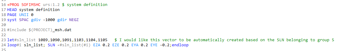

For loading/modelling reasons in the following programs, I’m trying to obtain an array/list with all SLN belonging to a given group, following definition of these elements in sofimshC.

The idea here would be to alter sofimsh_C generated elements in the main teddy file, after definition. Thus, I would need the vector #sln_list to be automatically generated based on the sln found in group 5, for instance:

I want to perform a buckling resistance analysis and check all bars within a certain group. For example, all columns are in Group 2. In BDK Teddy, I would like to obtain the list of SLNs from Group 2, so that I can then perform the analysis of those structural lines.
