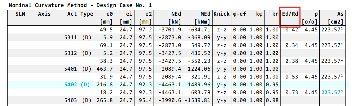

Now I have other question. Is there a possibility to check how Sofistik is calculating the Ed value?
It’s strange, because the module Column says that Ed/Rd is arount 75%, but when I run just AQB module witchout II’nd effects, the stresses are too big.
