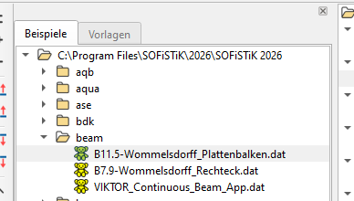

The Module Beam is designed for a quick design check in building design, but NOT for Bridge Design. Please read the BEAM manual as well for further information. There you will find the explanation, that the program BEAM currently supports the shape of a rectangle, t-beam and an edge beam.
You will find pure TEDDY examples from TEDDY menu HELP > Examples

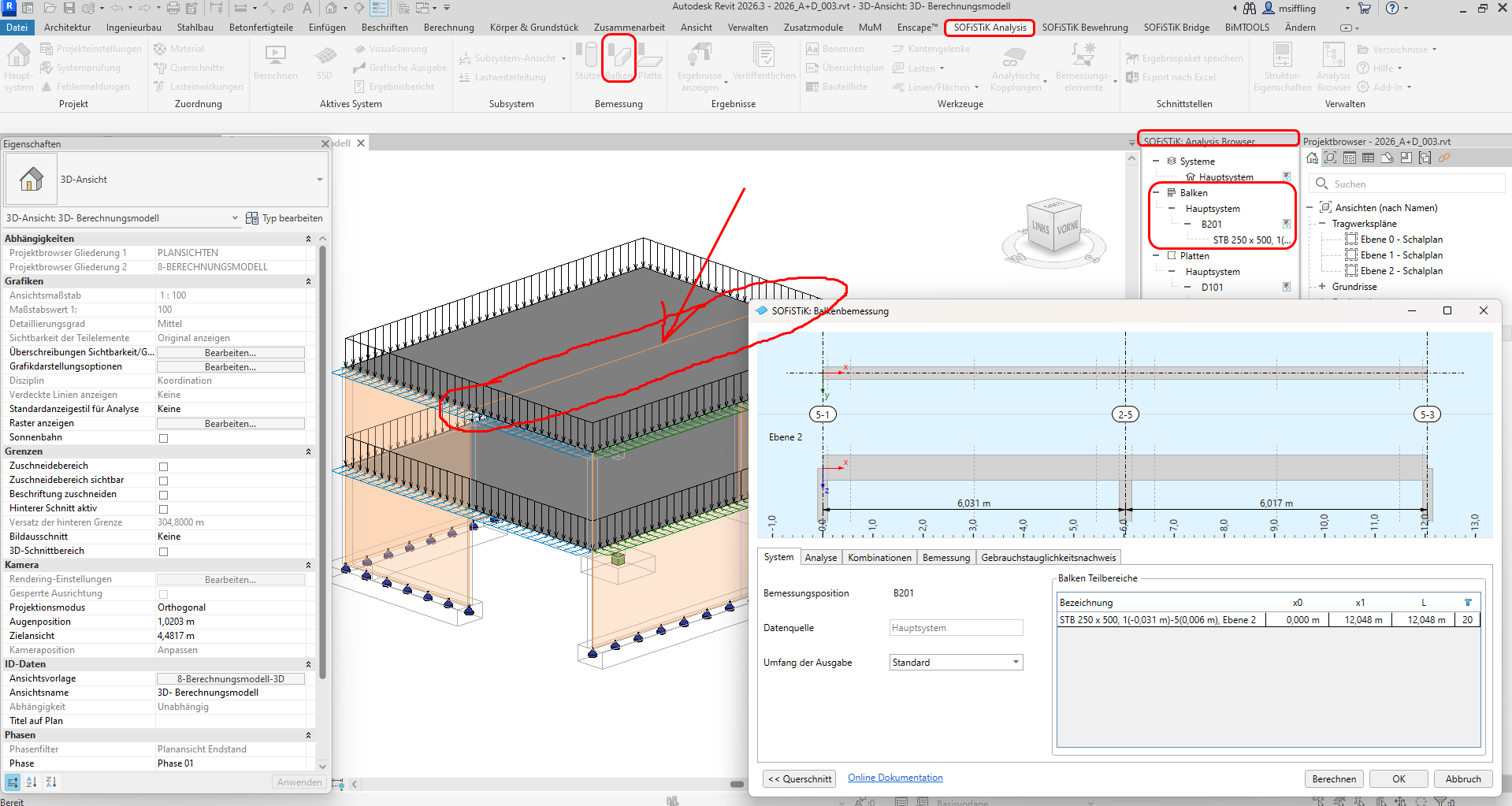

Most likely the BEAM should be used inside the Revit context. Together with SOFiSTIK Analysis + Design, you can perform very quickly a design check inside Revit. This is the main use case.
Nevertheless you can also use the common way with modules AQUA, SOFiMSHC, ASE, MAXIMA and AQB for design. Especially for general cross sections defined in AQUA.
