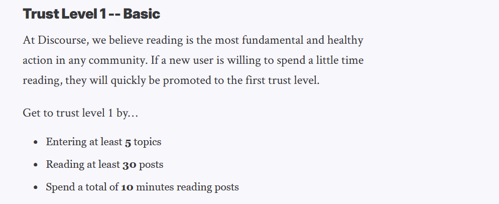

It doesnt allow me to add the .sofistik and .dwg file here
Hi nik,
You have to reach trust level 1 to upload files. This can easily be achieved.
