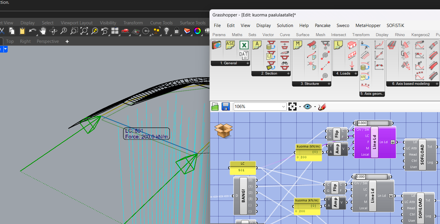

Any hint how to add to line load 2 different values at end points of the line?
Hi MoMo!
I can see you’re working with an older version of the SOFiSTiK Interface.
In the newer version, the load components have been reorganized into Hosted Loads and Free Loads. The line load component now offer separate inputs for the start and end values.
I’d recommend updating your SOFiSTiK Interface to the 2026 version to get this functionality. Otherwise, you can still define a trapezoidal line load manually through Teddy.
