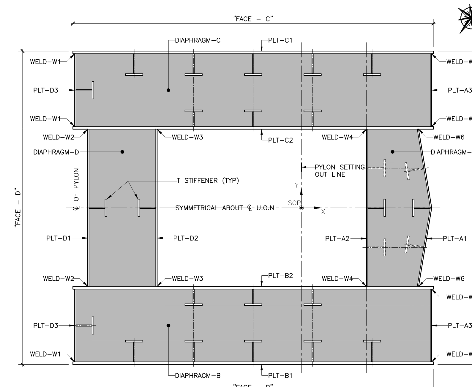

Thank you for your message. I have a steel box girder that is infilled with concrete, i.e. my concrete part cannot be represented by a thin walled element. See below example of section I am looking for, where the hatch represents concrete.
I have the thin walled parametric section fully defined. I am looking for a way to include the concrete.

in my opinion it is a solid section because the shear stresses will not be constant across the thickness.
