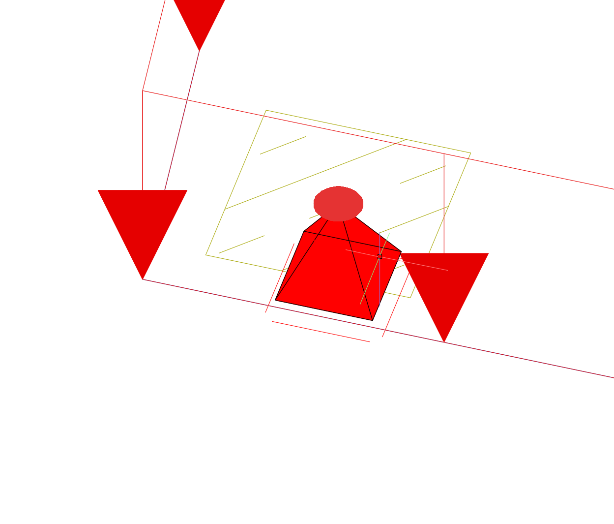

Greetings,
i got a 2D-FE-plate modell and i want to have a traction support instead of a compressive force support. But if i try to turn it with the comand “SOF_SE_ORIENTATE” it wont change anything.
kind regards
Needs to be upside down
Greetings,
kind regards
Hi Thomask,
compression only/tension only supports only work if you use nonlinear spring elements instead of fixed supports.
Nora
