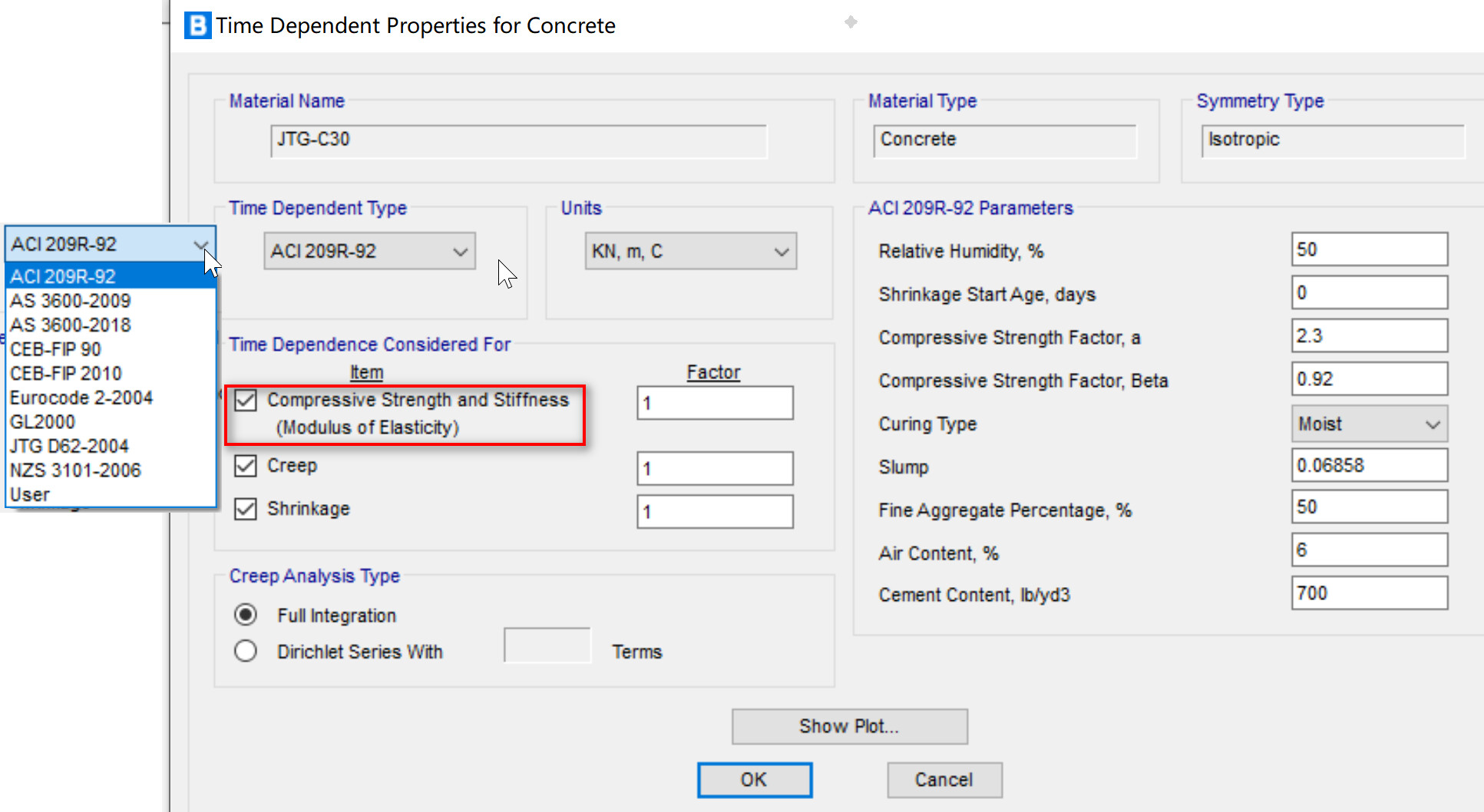

In Eurocode and other design codes, like ACI 209R-92, there are time dependent concrete strength and elastic modulus.
Midas and Sap2000 allow for these features.

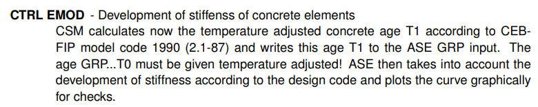

If you use CSM, a time dependant E-Modulus according to FIP Model Code 1990 is used by default (see CTRL EMOD AUTO).
Regards
gmay
Thanks for the tip.
Unfortunately, according to CSM manual

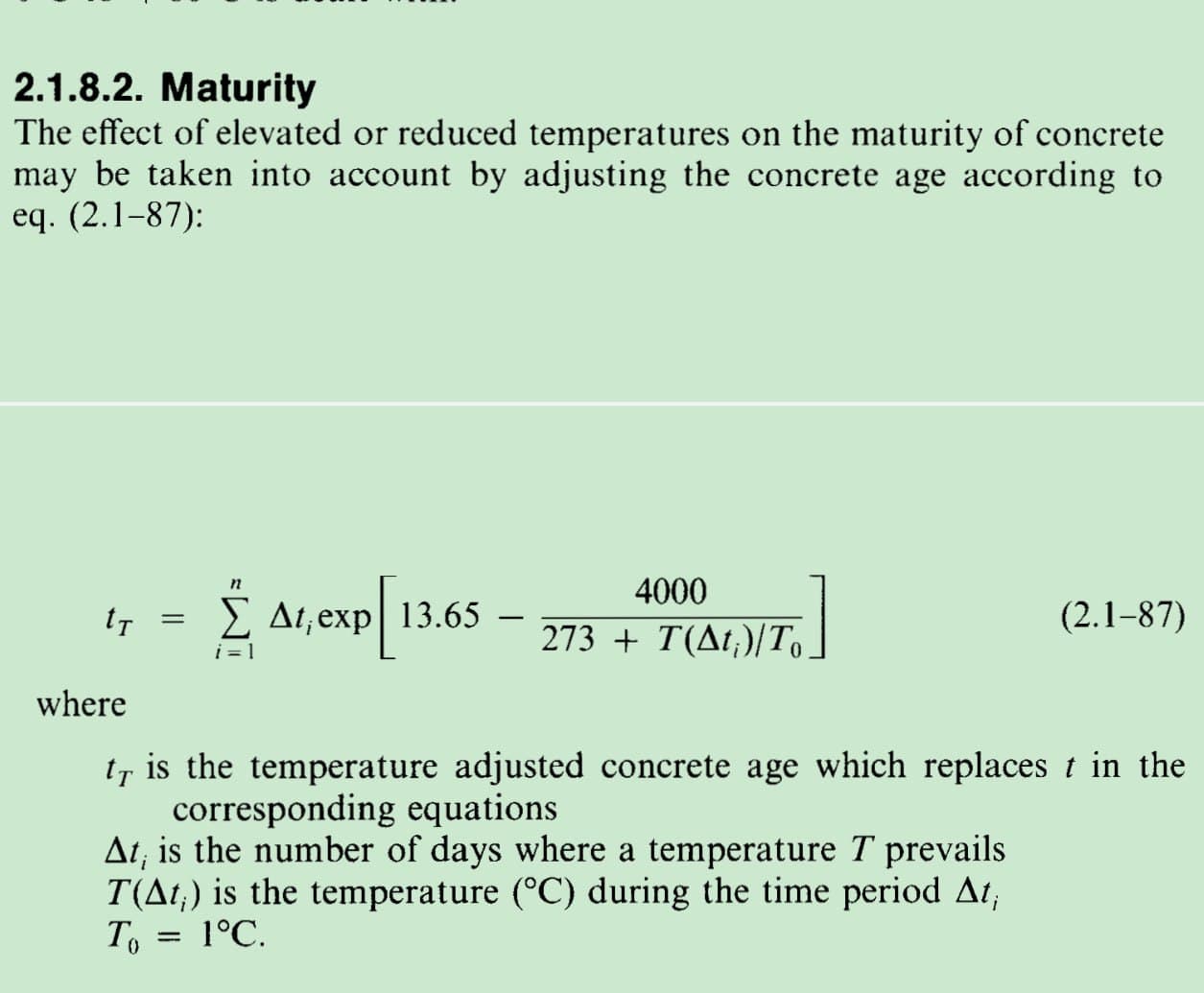

But according to FIP Model Code 1990, it has something to do with temperature, NOT with time
The adjustment is time/age dependent.
However since concrete matures quicker at a higher temperature a concrete sample stored at 20°C will have developed more strength than a sample at 10°C (given the same time)
Therefore you need to calculate “temperature adjusted days”

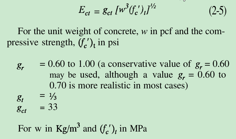

Thank you.
But I want to use ACI code instead of CEB-FIP
