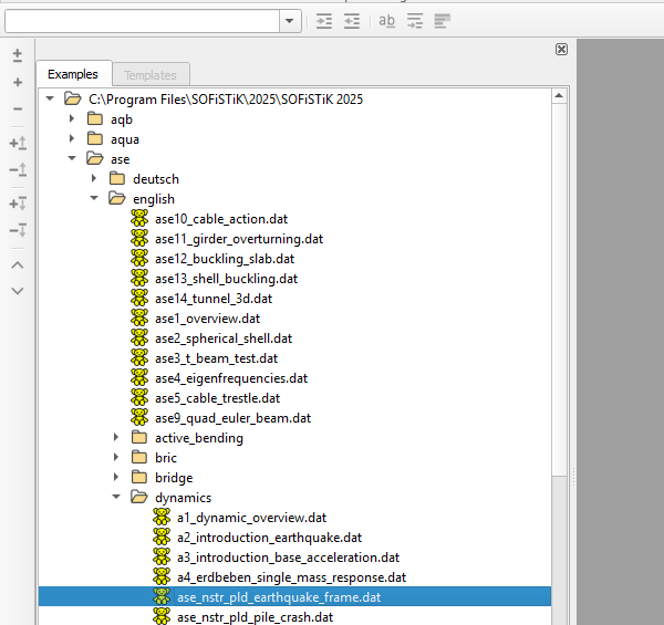

Hi Amine,
yes, I managed to complete the time history analysis in ASE.
I followed the Teddy example as per snip below.
It’s tricky at first and in my case calibrating the model and the analysis was a challenge. But I managed to accomplish the task.
