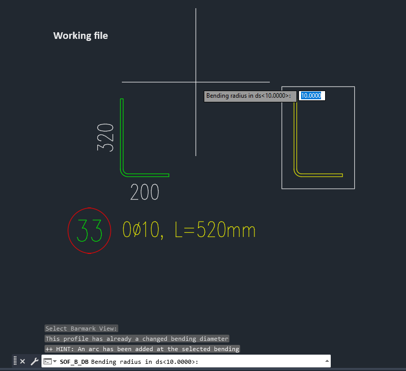

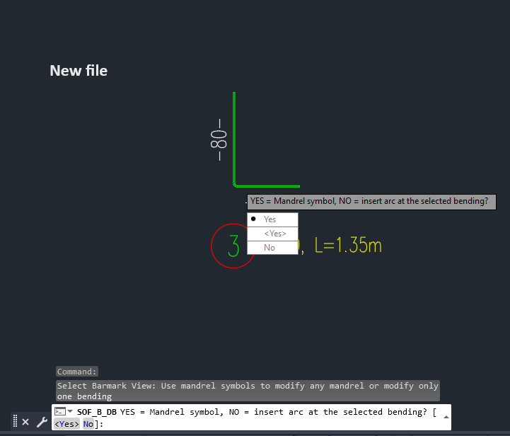

Hello. When selecting the BAR BENDING DIAMETR command, the window offering the option to display the diameter or not has stopped appearing. The diameter itself can still be applied, but there is no designation.
Could you please advise how to enable this function? In a new file, everything works fine, but in the saved working file, the window does not appear.

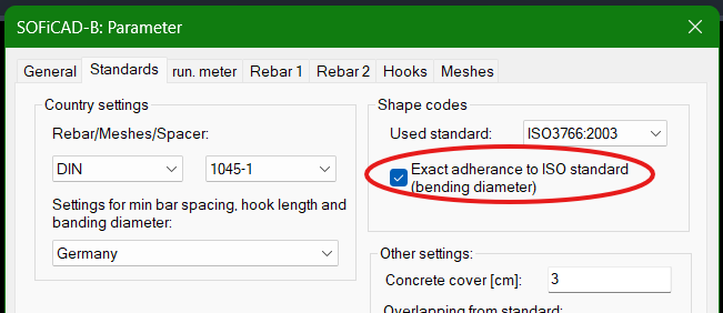

In the Reinforcement parameters → Standards there is the option Extract … . This must be deactivated.
Thank you a lot!!! now it works
