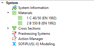

Second thing ive noticed, is when i define my worklaws, usually - they would show up under my “system” tab, as worklaws. In this model, they do not.
Normal output:
Output in my file (no work laws created, but they show up in the report?):

It was indeed ASE not being to recall the worklaws i have defined. For it to work, i have to add a “Work law” task under system. It will be empty on the first run, and then get assigned my worklaws when running AQUA.
