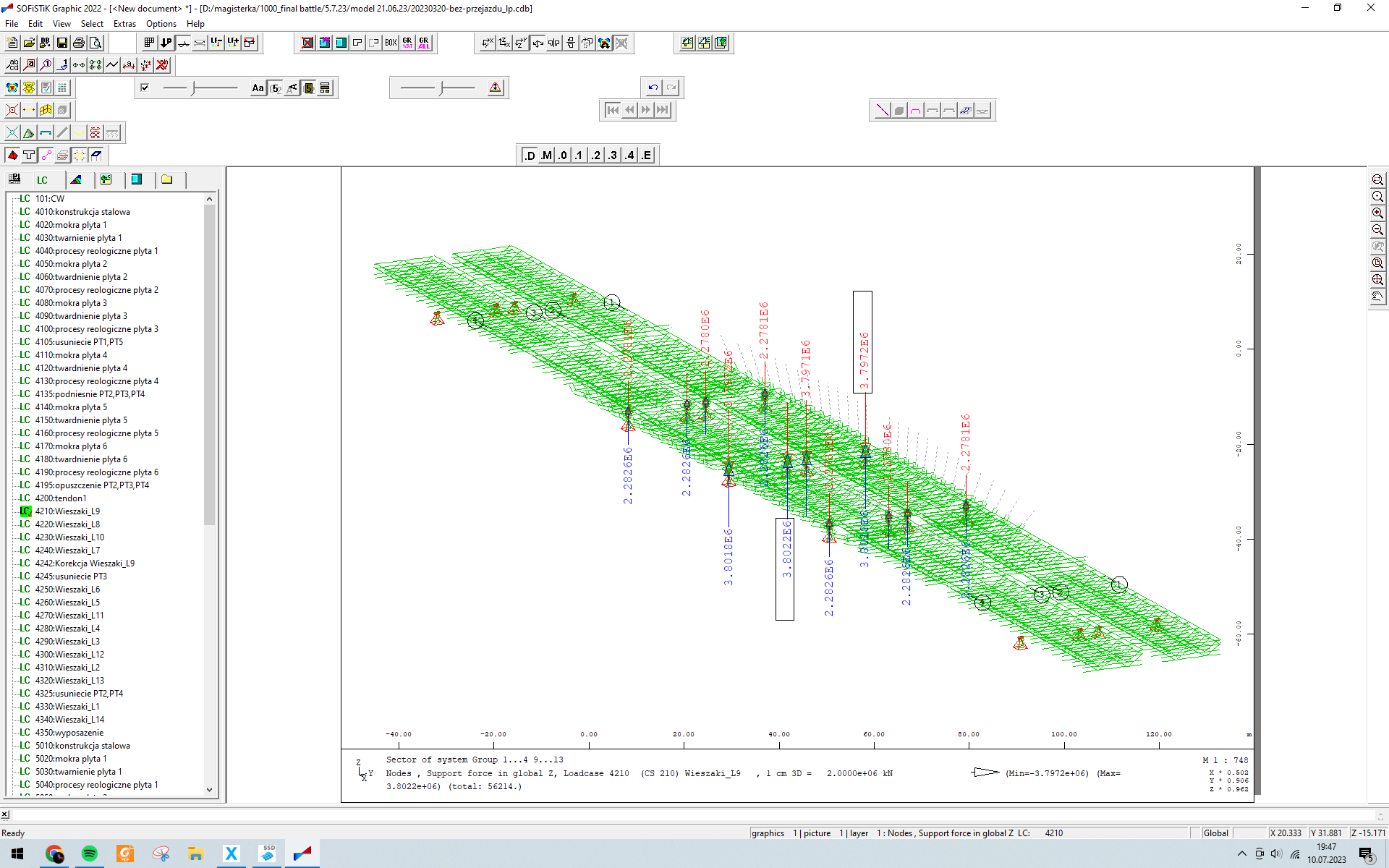

Hello, do you have any ideas why do results of support forces are shown in this way?
Seems like doubled node fixings or constraint overdose and probably shrinkage cause extra forces.
