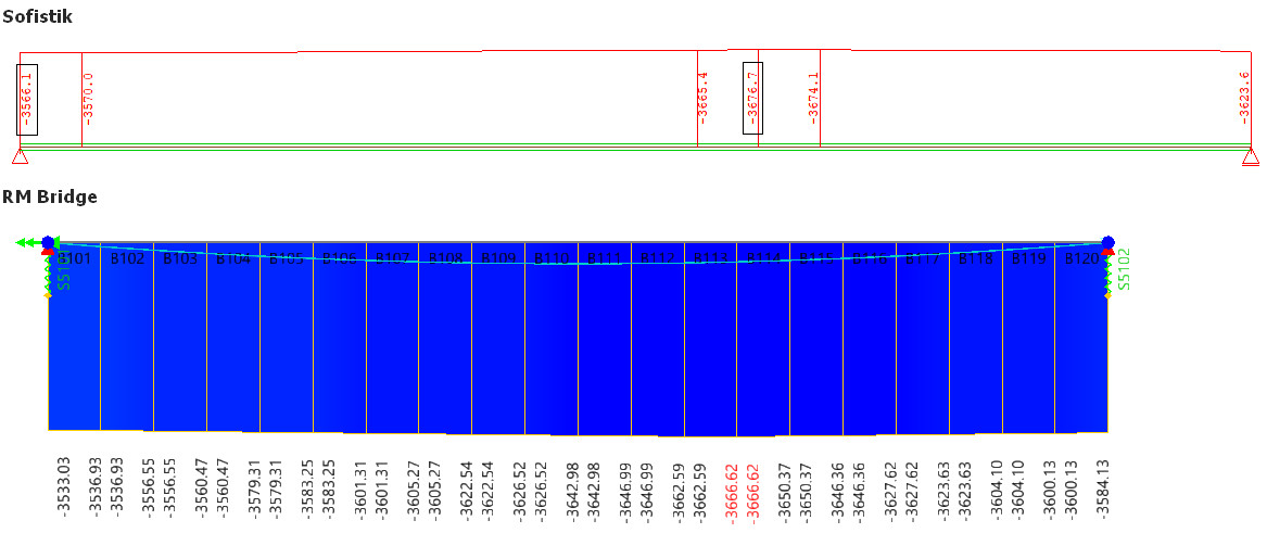

Below is the axial force from Sofistik and RM Bridge (TDV) in the beamin CS11, Both softwares shows similar results (about 36XXkN).
CS 11 TYPE P TITL ‘Prestress’

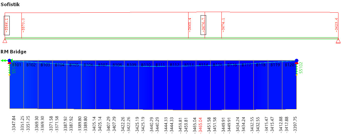

Below is the axial force from Sofistik and RM Bridge (TDV) in the beam in CS15.
CS 15 TYPE C_2 TITL ‘C+S t-infinite’ RH 80 T 999971 NCRE 10
By comparing the above 2 images, you will find:
The axial force from Sofistik does’t change from CS11 to CS15, while it decreases in RM Bridge (34XXkN in CS15 verse 36XXkN in CS11)

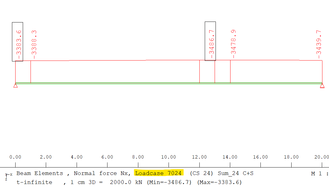

I find that I can use
+PROG WING urs:2
head
LC 7024
beam N
to get axial force.
