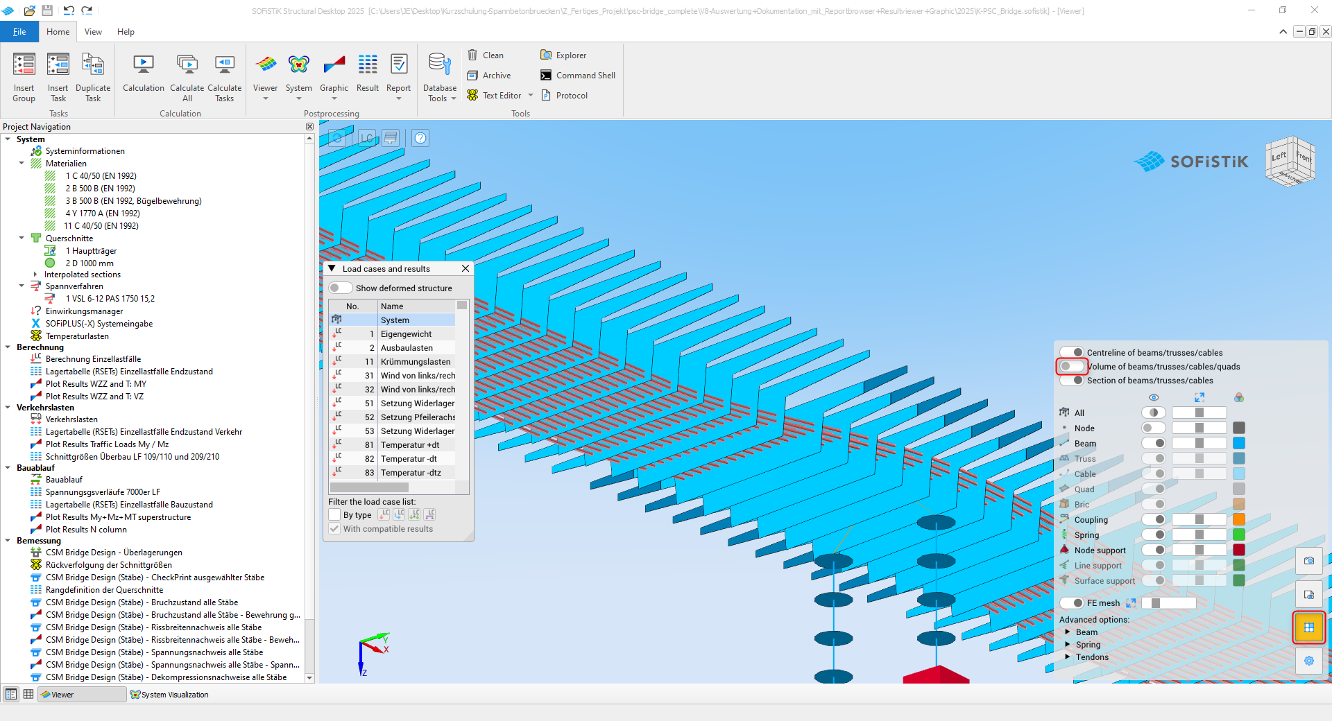

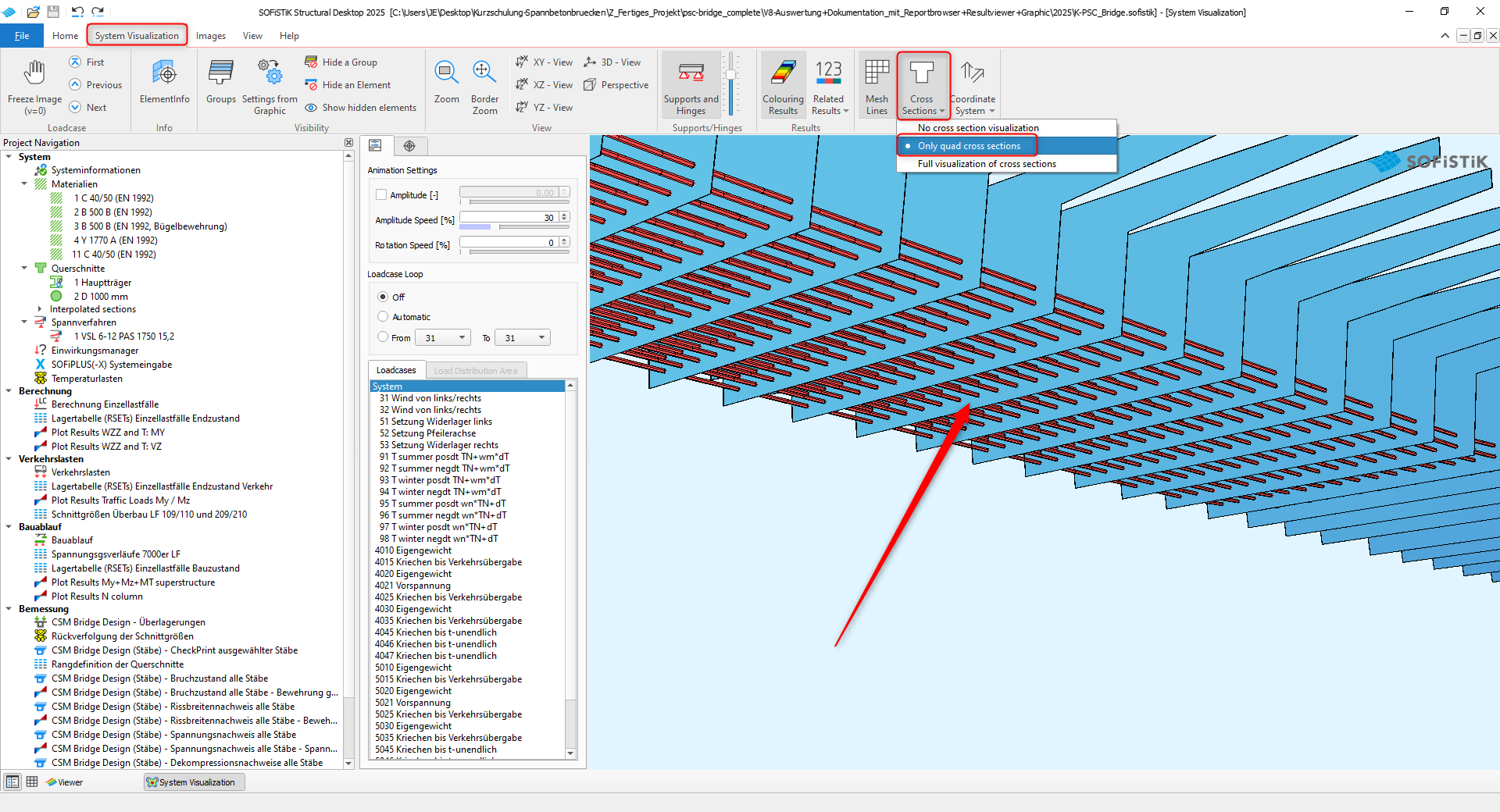

The algorithm checks the defined minimum edge distance. If it is undershot (or if the algorithm assumes it is), a warning is issued. Since the algorithm does not work perfectly in all cases, this should be verified manually.
This can be done in the Animator or also in the Viewer—see screenshots. This allows you to identify where the edge distance becomes small.
