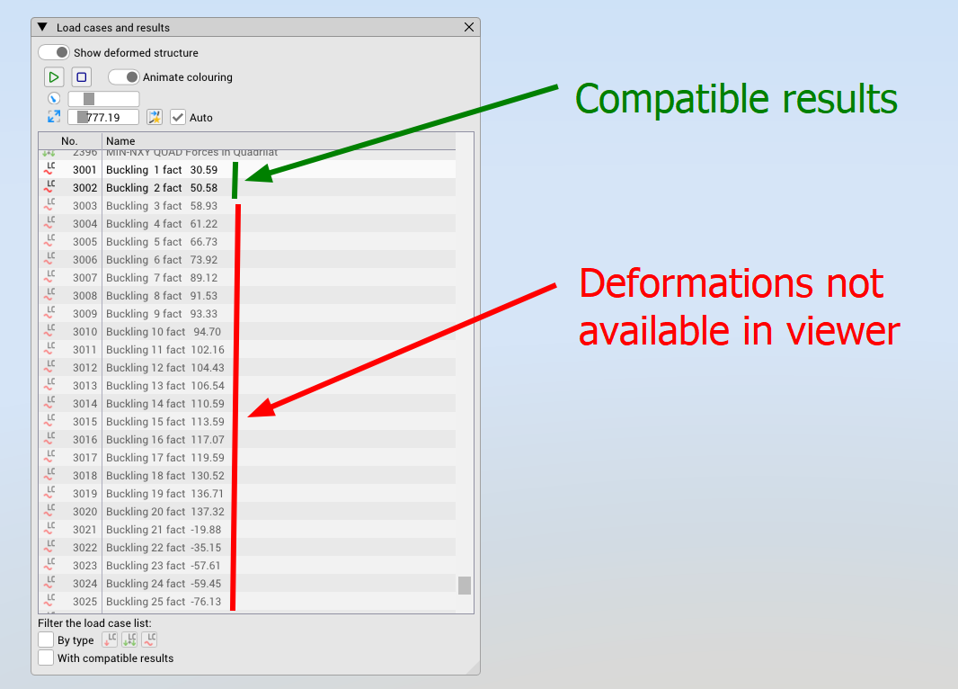

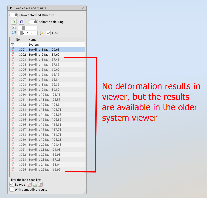

I have encountered the following problem. After calculating buckling modes I noticed that most of the modes are not available in the Viewer (I am only able to select the first two modes):

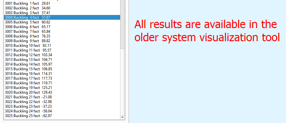

However, all of the buckling modes can be viewed in the older system visualization tool:

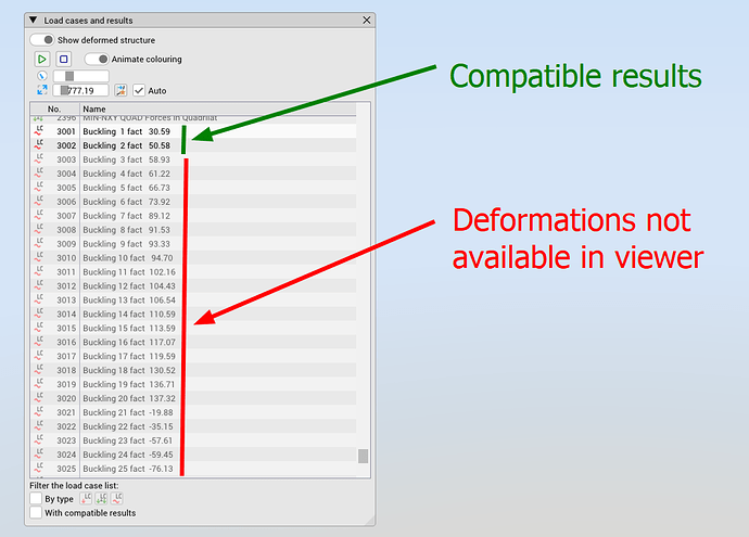

I am using SOFiSTiK version 2025-6 and for some reason most of my buckling modes are not available in the viewer:

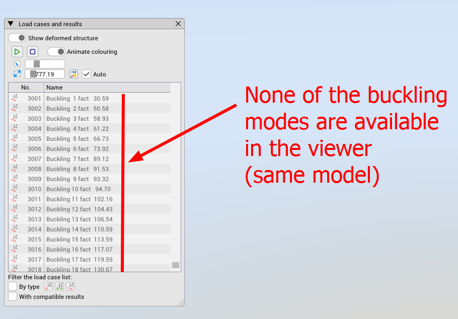

And for some reason the available results differ every time I perform calculations. For example I calculated the same model again without changing anything and this time none of the buckling modes were available in the viewer:
All of the results are available in the older System visualization tool

Hi @MartinT ,
The Viewer considers a load case compatible if node deformation data is available for that load case. Maybe you can try deleting the *.sqlite file (the Viewer must be closed) and then re-open (in case of a syncing problem).
If not, please reach the support ( Technical-support SOFiSTiK AG ) and attach your example to the message.
Mathieu
Hi @mcalvo
Deleting the *.sqlite file solved the problem. Now all of the buckling modes are visible.
Thank you very much for the fast reply.
