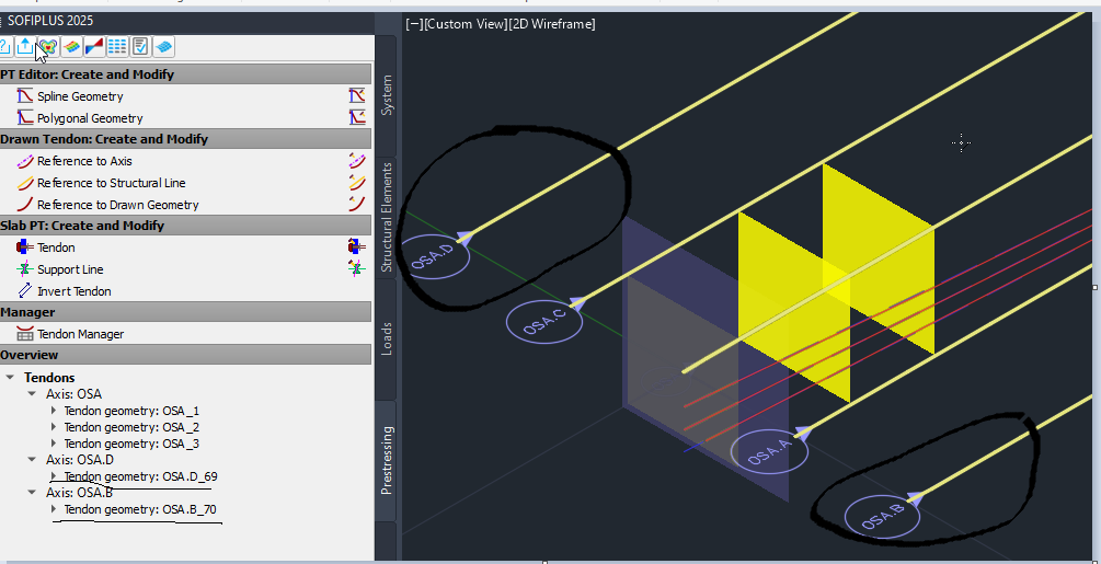

After I defined prestressing tendons for beam its not possible to copy/clone tendons to different axis.
For example, I defined tendons for axis A, and copy/clone to axis B. In command line show up-No such node. In Overview there are informations about tendons in axis B, but in 2D Wireframe I don’t see anything on axis B. Same results with PT Editor/Spline Geometry. Do you have some advice?

Thanks for getting back to me,
“copy to another axis” also doesn’t get any result. In SOFIPLUS(X)-Modeling, there are no tendons on axis. After export model from SOFIPLUS(X) to SSD, tendons appear in SSD on axis that was the problem.
1st picture There are no tendons on axis, but overview show informations for tendons.

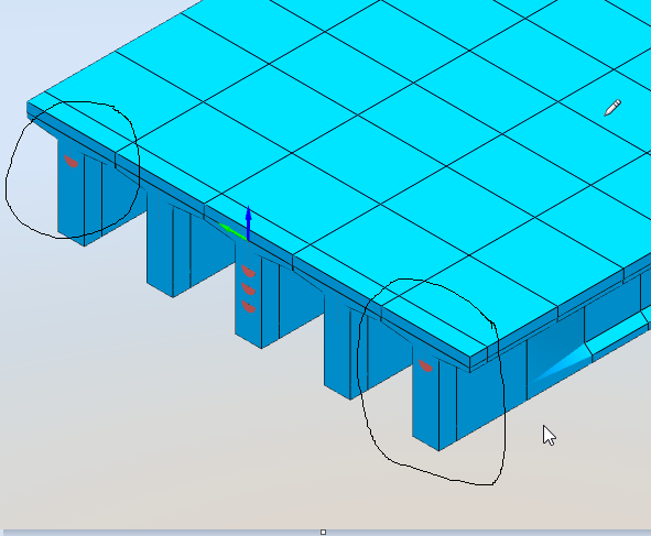

2nd picture In SSD, tendons shows up.
Why I can’t see tendons in SOFIPLUS(X) ?

Can you upload the file? Then we can check it.
AutoCad reinstalled, problem solved.
