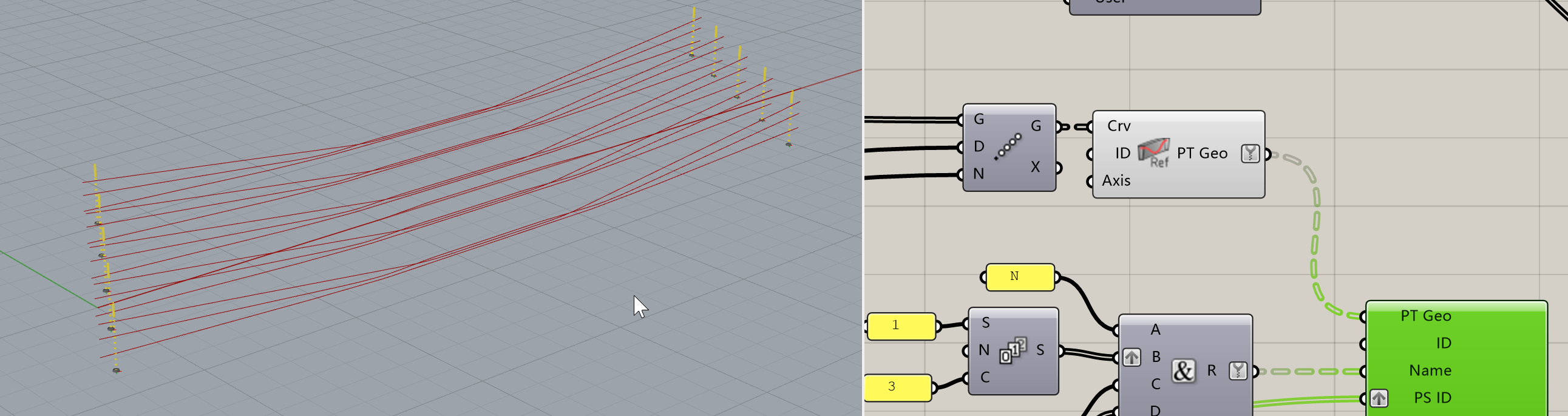

The tendons are modeled as curves in the Grasshopper and they are shown as continuous curves

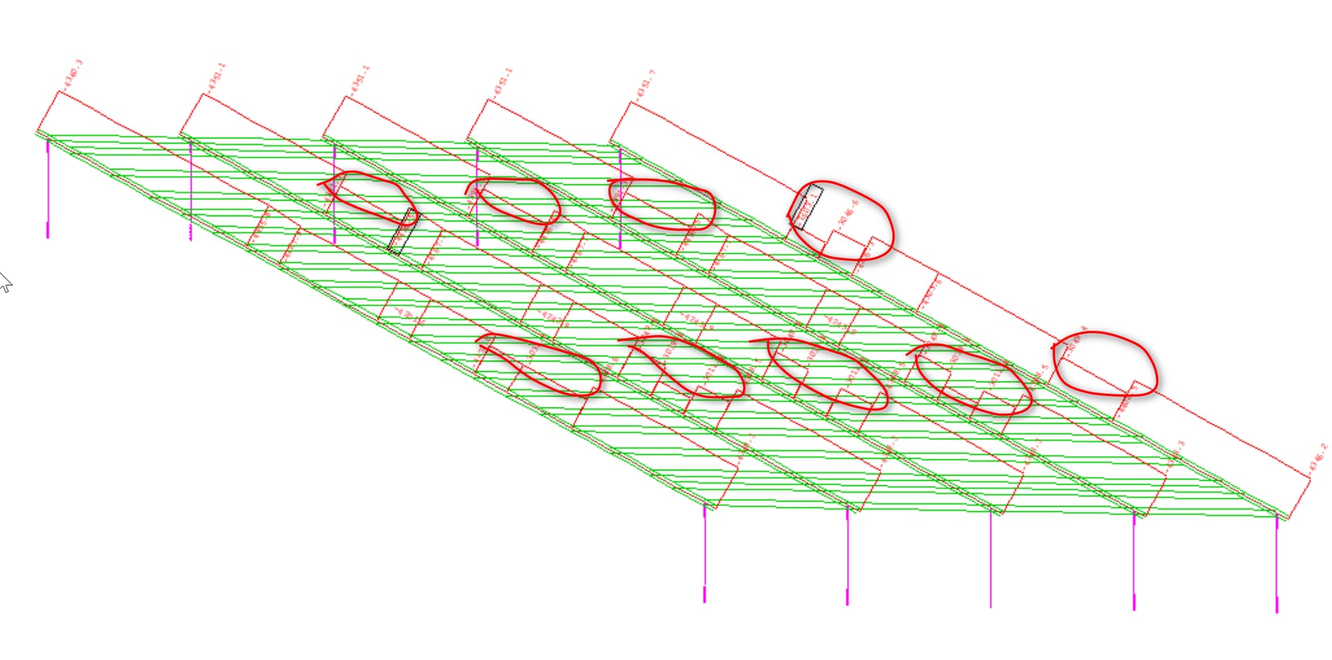

After analysis, parts of the the tendons disappear
This is not just a rendering issue, the axial force due to prestressing decreases at the places where parts of the tendons disappear
