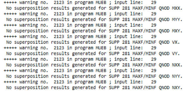

I have designed a frame bridge made of structural elements. The wall and the bottom deck are supported by bedding.
When I am doing the superpositoning of combination rules, I get the warnings in the picture. I am not sure, if I should ignore it? I get results in wingraph of MXX, MYY and so on for my quad elements.

no, you should not ignore it. This warning message can have various reasons. Could you provide the full text input here in the chat?
This warning appears if there are load cases without results in nodes of quad elements.
This can happen if one calculate internal forces with ELLA because ELLA only produces results in middle of elements and not on node of elements.
Another reason can be that you made a presuperposition without superposing QNODs. In a further superposition these results fail.
Oh okay, thank you! I have calculated results with Ella. But does this mean, that the results from Ella are not combined with the other load cases when doing superpositioning?
