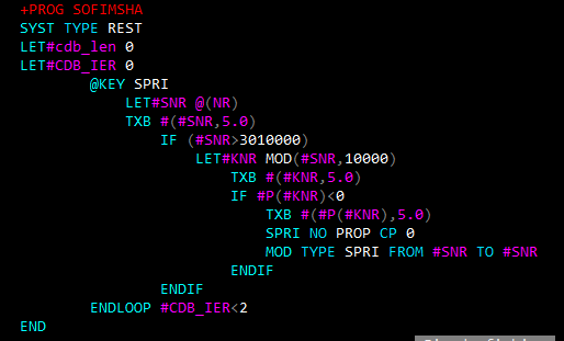

Try to follow this structure and use the XB command to check what falls within the IF conditions.
