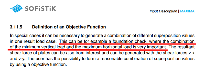

Documentation of Maxima describes objective functions and also mentions that they can be used to find combinations of minimum vertical load with maximum horizontal load:
Has anyone been able to find/derive a good objective function for finding the combinations with minimum vertical reaction and maximum horizontal reaction?
Currently, I have been able to get the best results with objective functions of type “PZ+PX*factor”. Where the factor has a weighing and direction purpose. Of course, this is not an exact solution to maximising (PX1+…+PXn)/(PZ1+…+PZn) and with table analysis I can find worse combinations.
