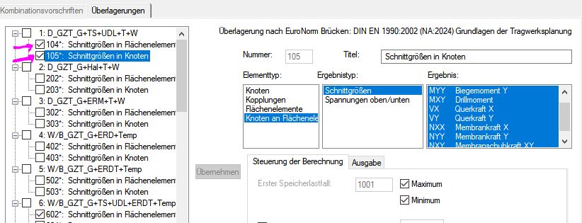

why do i get this warning;
+++++ Warnung Nr. 2123 in Programm MUEB ; Eingabezeile: 18
Keine Überlagerungsergebnisse für SUPP 1 MAX/MIN QUAK MXX erzeugt.
and i wanna know in which case do i have to run the Schnittgrößen in Knoten and when is the Schnittgrößen in Flächenelementen enough? because i am kinda confused. i used to run both until i get this warning so i started to ask myself why do we need it?
from your description it is not possible to give a clear answer. There are lots of information missing. My guess is that you are performing a bridge design and use the “Traffic Load” = “Verkehrslasten” task which uses the module ELLA. This module is not able to save nodal results from the evaluation. This may be the reason for this warning.
Please check your input in this direction and read the manual.
If this is the reason there is nothing you can do with this workflow except to delete the maximal superposition for QUAK :wink:
thank you so much!
