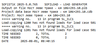

I have problem when i try to copy loads from ella module for specific elements. I get this warning massage:
This is teddy input from Traffic Loader:

And this is input for load copy"
+prog SOFILOAD
head ELLA
LC NO 501 TYPE NONE
COPY NO 110 FACT - TYPE ELLA REF AXIS.20 CASE 1 NRE 1100028
COPY NO 110 FACT - TYPE ELLA REF AXIS.21 CASE 1 NRE 1100028
end
I want to add that this is single girder system. I also tried to add CTRL COPY 1 to load copy input and it didnt help.
Thanks in advance.
Hm, perhaps it’s simply the missing XABS in command COPY(?).
Hello, i tried adding that command and still i got the same warning.
Can you upload the calculable file or a reduced version of it?
