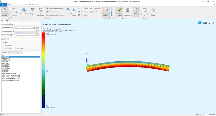

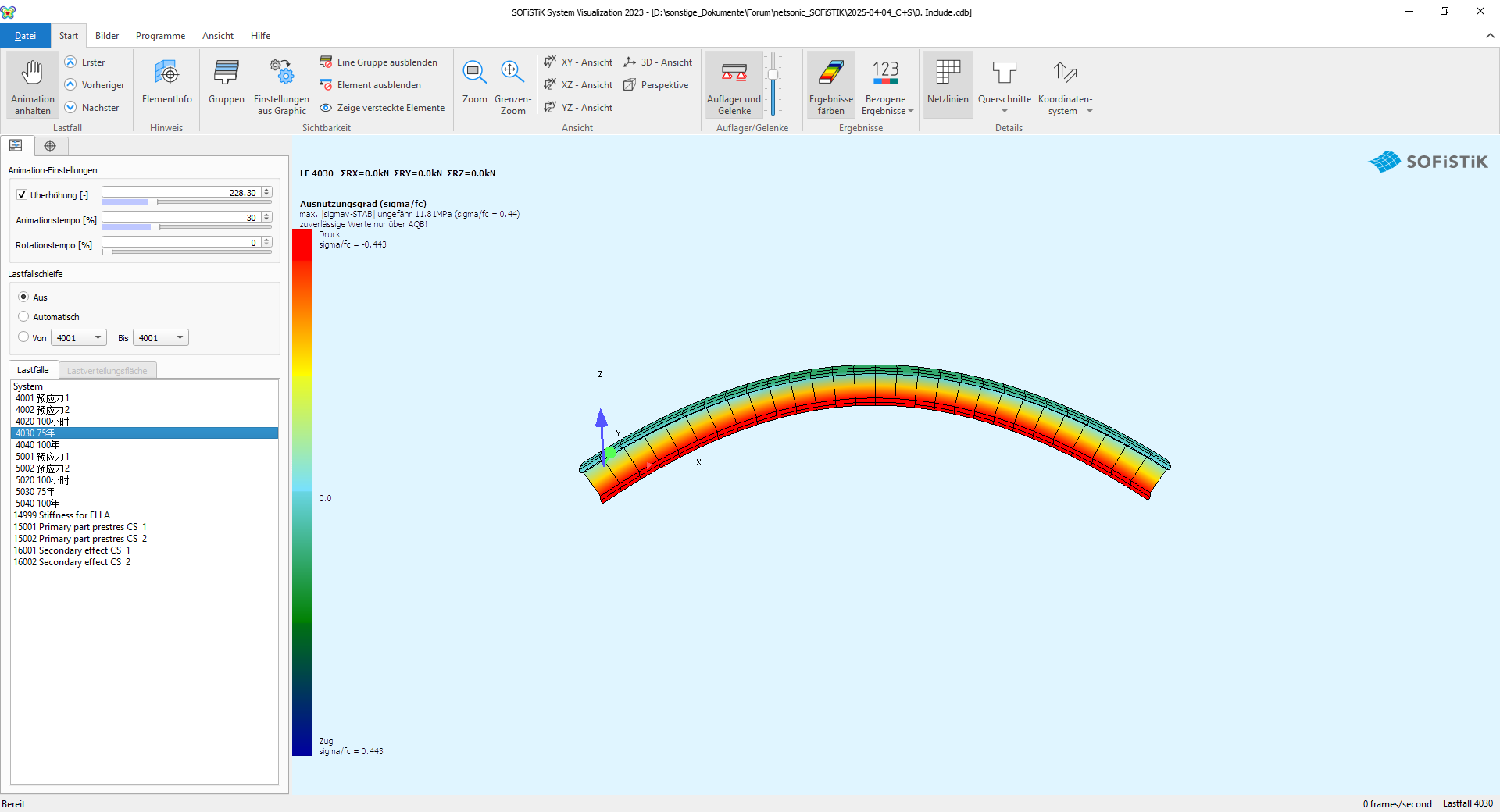

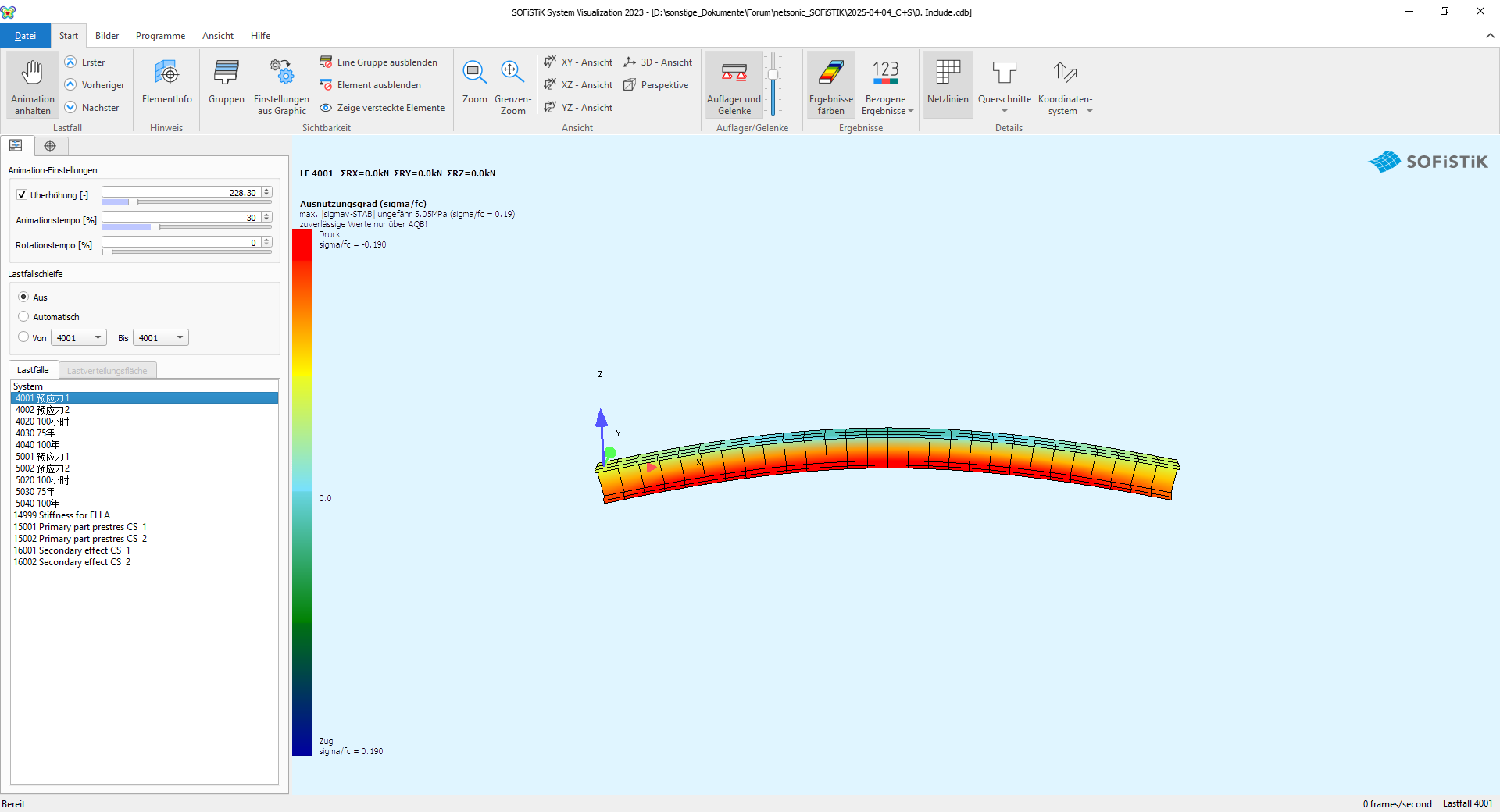

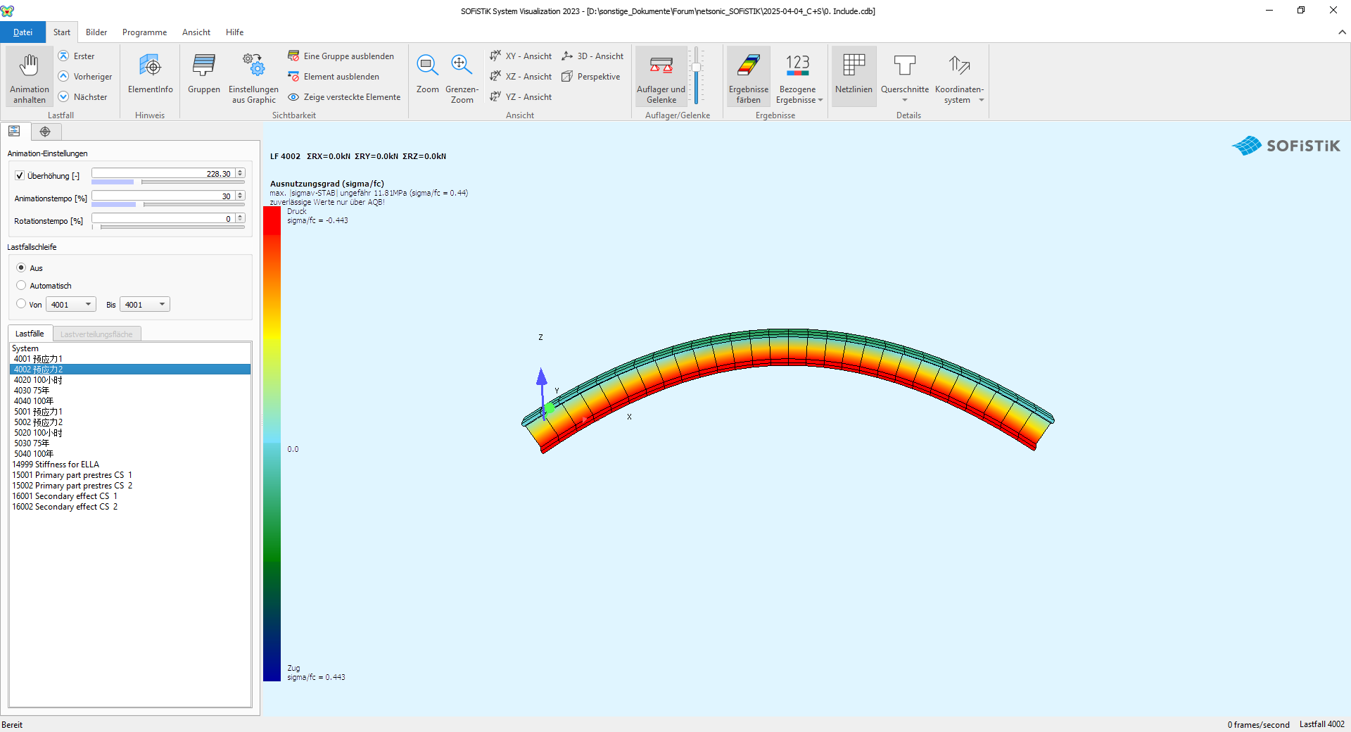

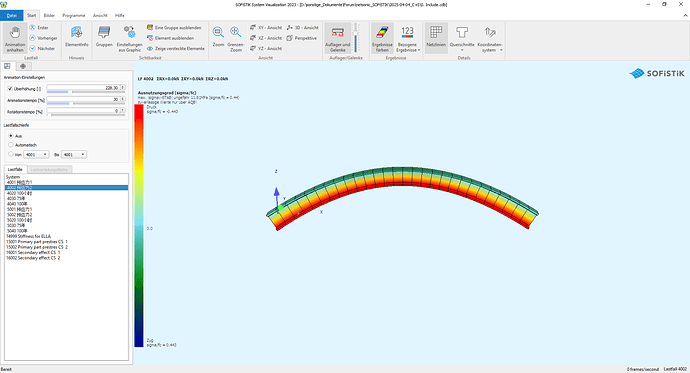

Below is my codes, plz run ‘0. Include.dat“, the creep and shrinkage is still effective.
0. Include.dat (107 Bytes)
Aqua.dat (1.2 KB)
CSM.dat (1.2 KB)
SofimshC.dat (1.3 KB)
Tendon.dat (3.3 KB)
I don’t understand what you are doing…??.
The screenshots show that there is no creep and shrinkage.
