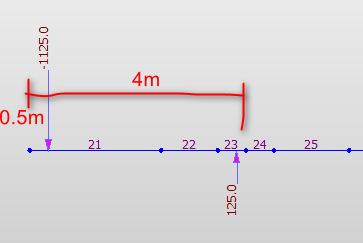

The SLN 21 belongs to GRP 101, while the remaining SLNs belong to GRP 100.
So for load=-1125kN, I can use this to define it.
| BEPL | FROM | TO | TYPE | P | A | REF |
| ‘GRP’ | 101 | PG | 1125 | 0.5 | S |
Is there any way to define the load=125kN conveniently without calculating its coordinates?
