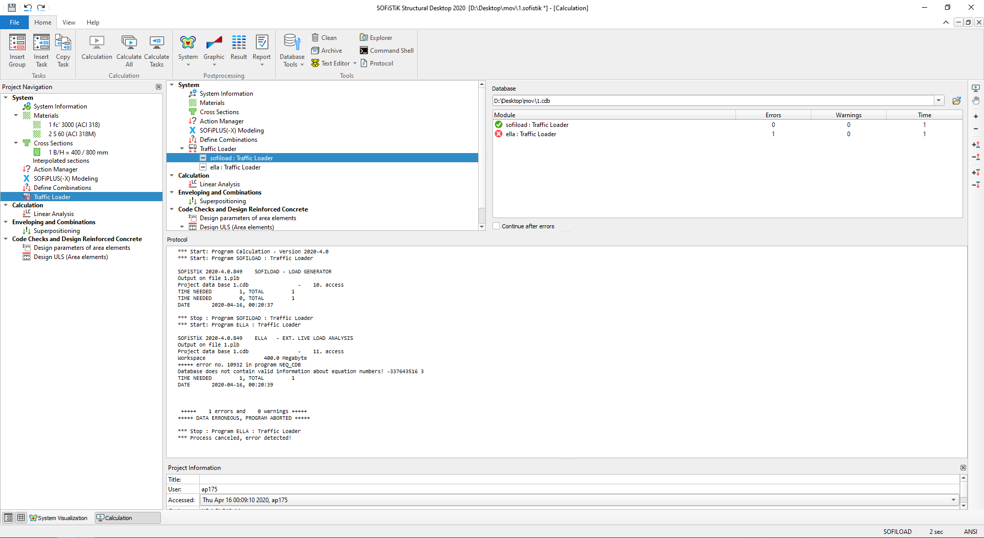

To day. I try use Traffic Loadder task. And i create Load Trains HT/HL93. But when i click OK it error at ella : traffic loadder. How i fix it
It is necessary to run at least one linear load case before evaluating the traffic loads with the influence line method. We recommend to do this analysis before the construction stage analysis to use the full developed stiffness matrix from the complete bridge.
You find further information about the trafic loader on our homepage:
www.sofistik.com > Documentation > Tutorials > Traffic Loader
Your SOFiSTiK Support Team
I try again and it successful.
