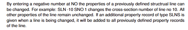

Yes, you can.
In SOFIMSHC, put “-” before the line you want to change.
“SLN -113 SNO …”
Before creating a topic you should always read the manual :wink:
Sz.
After changing the properties of an SLN you must mesh again! CTRL MESH 1 in SOFiMSHC!
