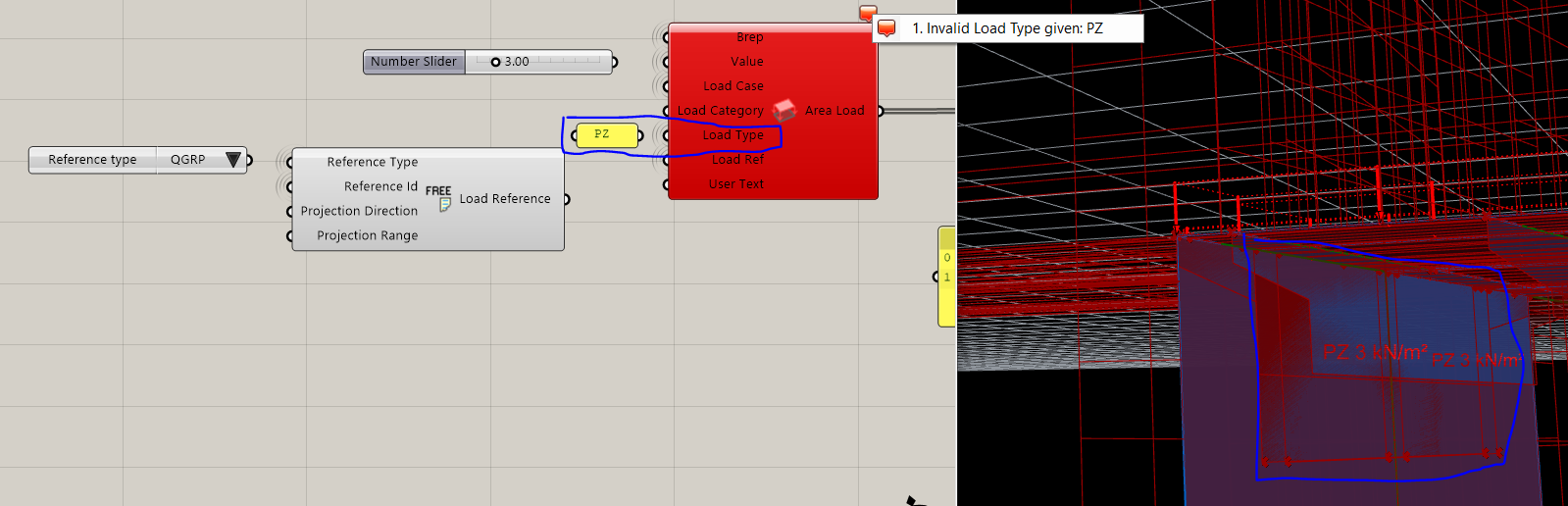

There is a errror in the Free Area Load component when entering data in the Load Type field:
  • The component is highlighted in red, even when the default value “PG” is entered.
  • The area load is displayed incorrectly in Rhino.

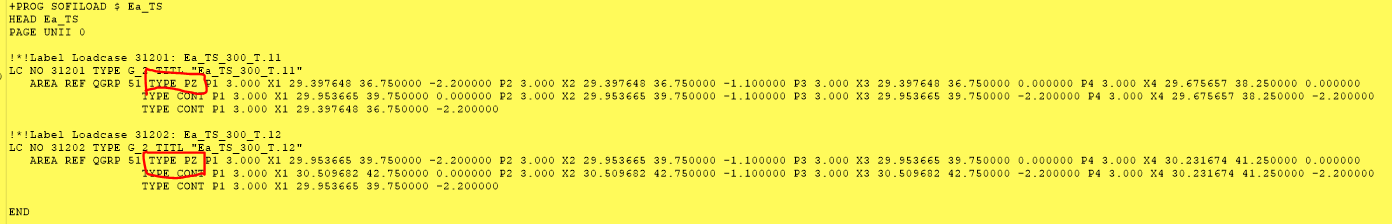

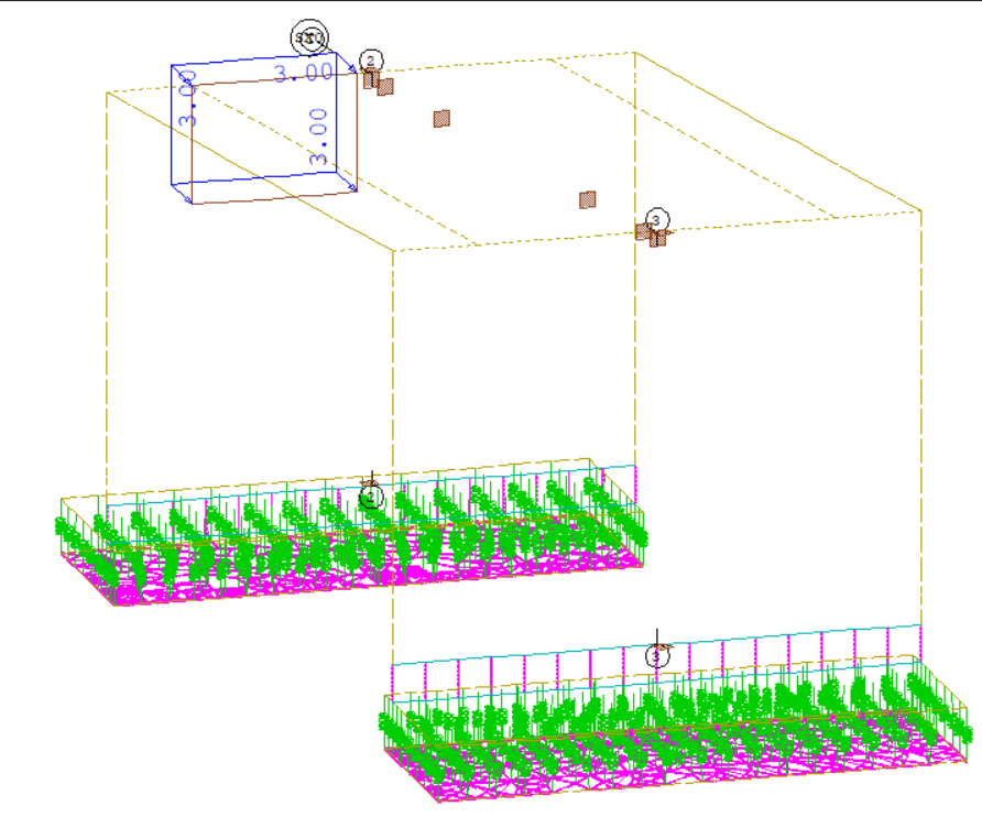

Despite the error indication, the component generates the correct Teddy text. SOFiSTiK processes the input file without any errors, and WinGraf displays the results correctly.

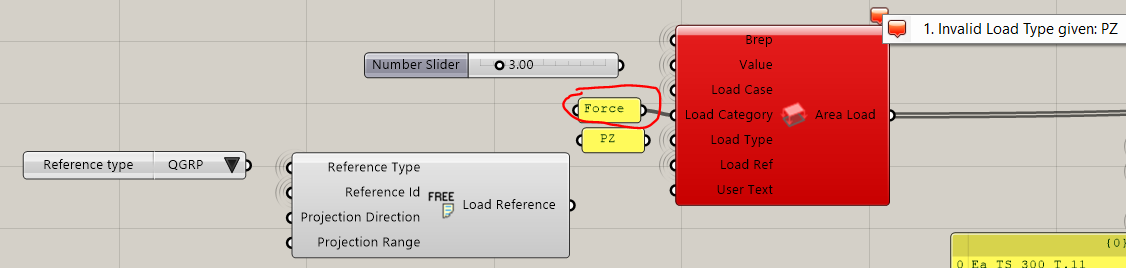

Hi Dariusz :slight_smile:
I didn’t connect anything to the “Load Category” input, but even after connecting the “Force” value, the error message still appears.
