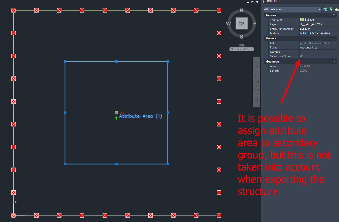

Would it be possible to add the option to give secondary groups to attribute areas in sofiplus?
At the moment you can sort of give the attribute area a secondary group but this is not taken into account when exporting the structure:

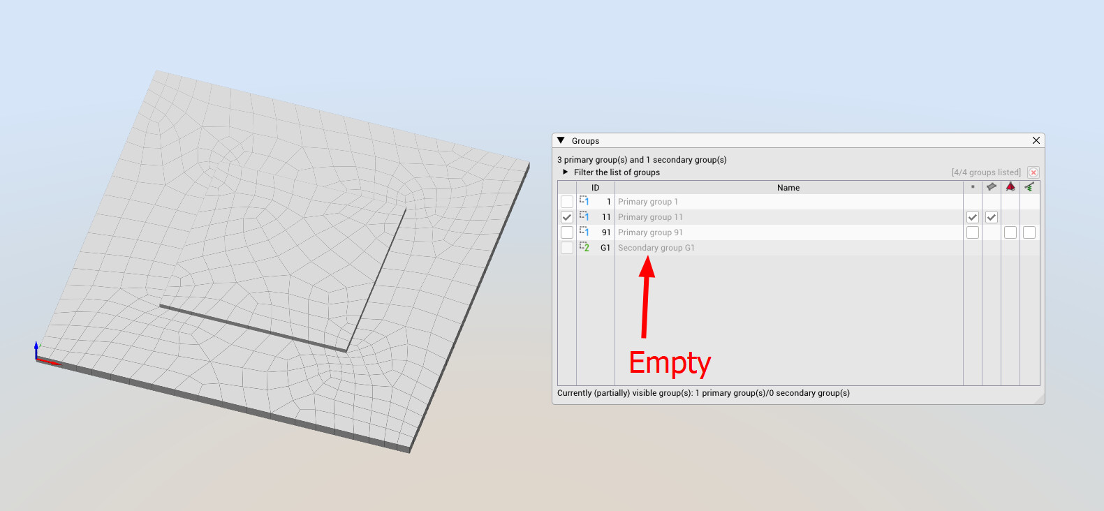

And it is also not possible to give string values to the primary group to assign the attribute area to a secondary group:
It is possible to assign attribute areas to secondary groups with Teddy input, but would be very useful if it was possible in Sofiplus also

Hi @SabineF,
Would it be possible to add the functionality of assigning attribute areas to secondary groups when exporting the model from Sofiplus?
Since secondary groups can be assigned to attribute areas in Sofiplus, it seems that it has been thought about implementing? However, at the moment exporting model from Sofiplus does not take the secondary group of attribute areas into account.

Hi Martin,
thank you for your feedback. We have turned it into an official feature request. However, when we will be able to implement it is still completely open, since our feature planning for version 2027 has already been finalized and no resources are available. Therefore, the earliest possible implementation would be with version 2028 (summer 2027).
