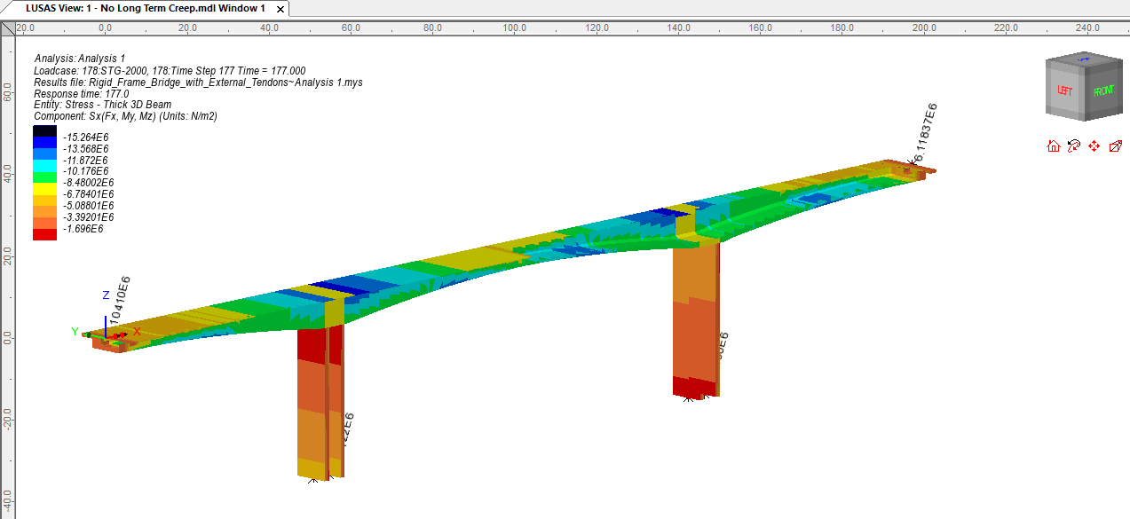

The RM-Bridge, Lusas, etc has a very useful feature: it can show the 3D stress contour for Beam Elements.
RM Bridge
Lusas
RM Bridge
Lusas

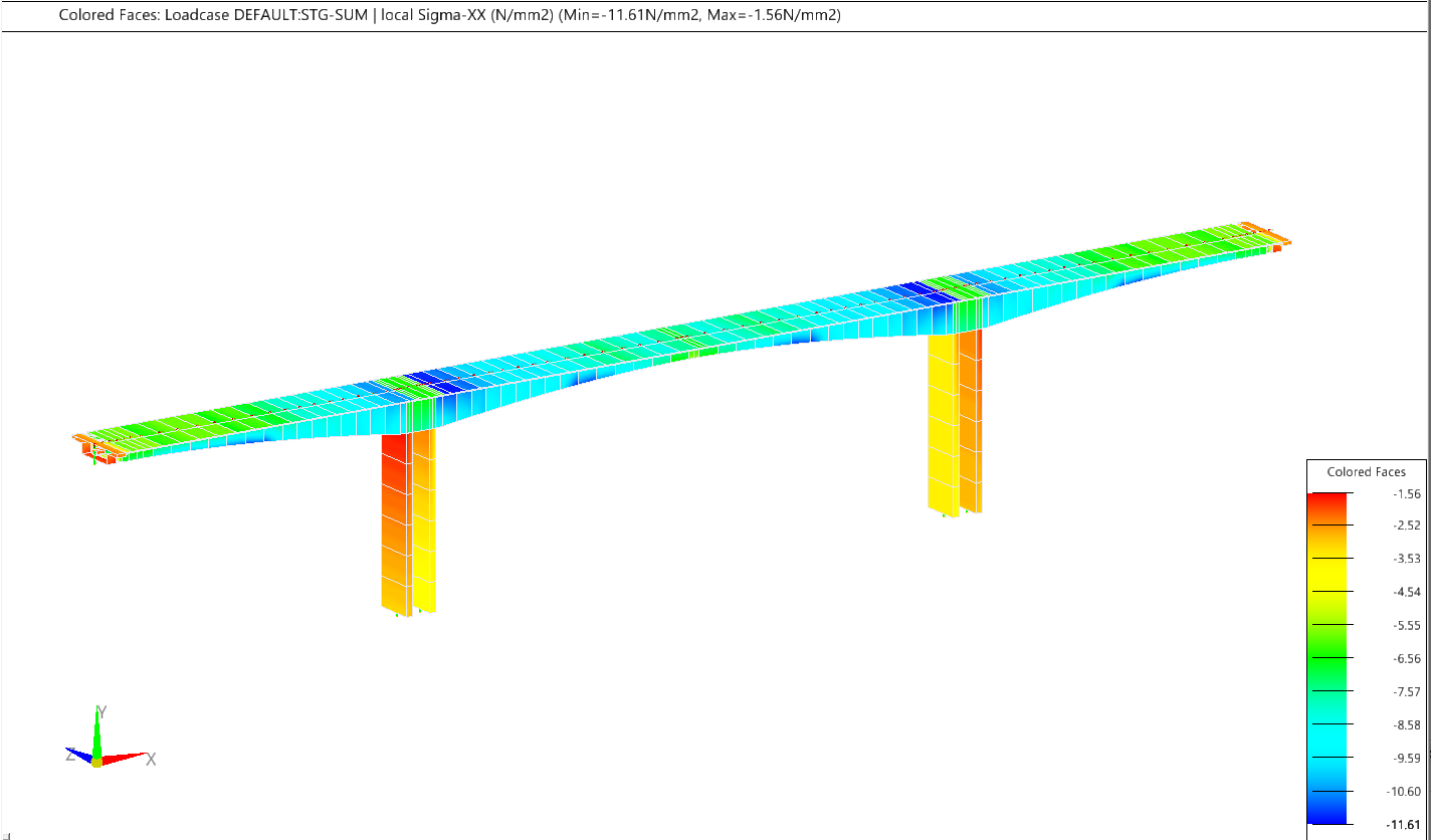

Imo sofistiks wingraf is far better and result graphs are more clear
Hate to check midas report with those color plots and without exact stress value on graph

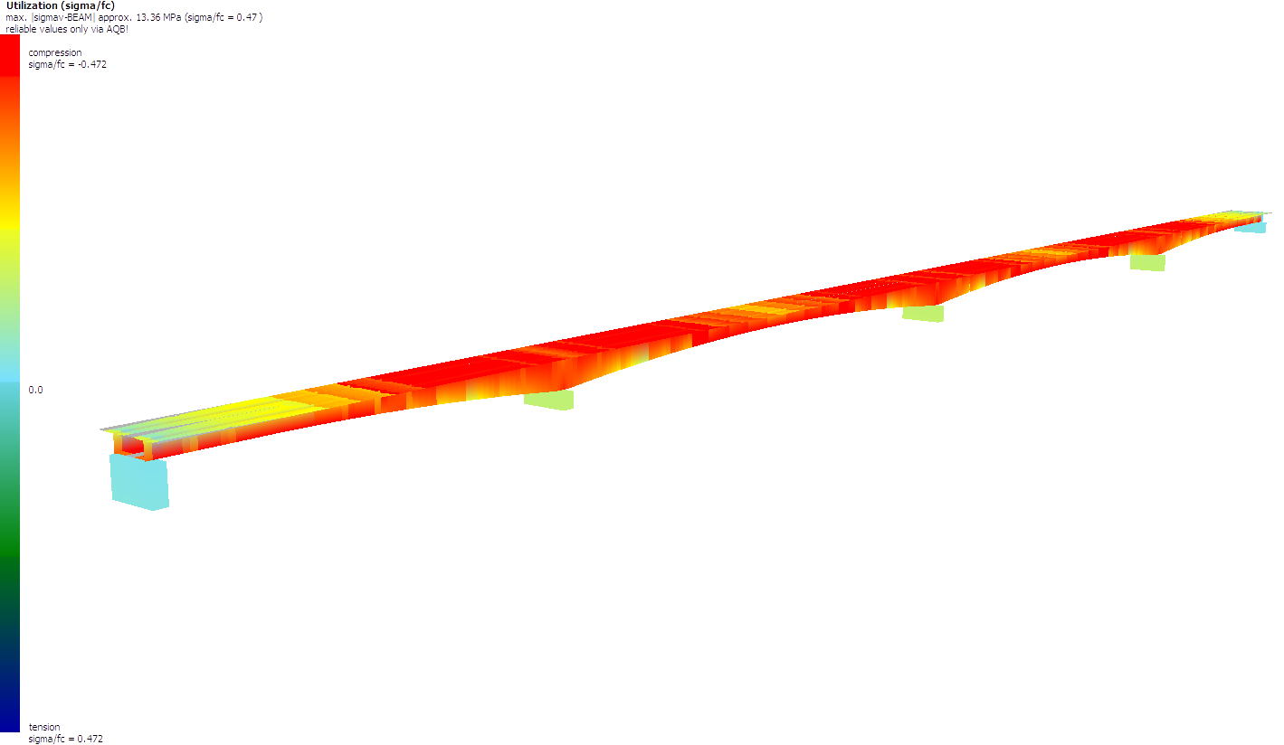

Anyway, does not animator do this?
The animator can show the the stress utilization, but users can’t select which stress component to show. While users can select various stress components to show in other softwares.
