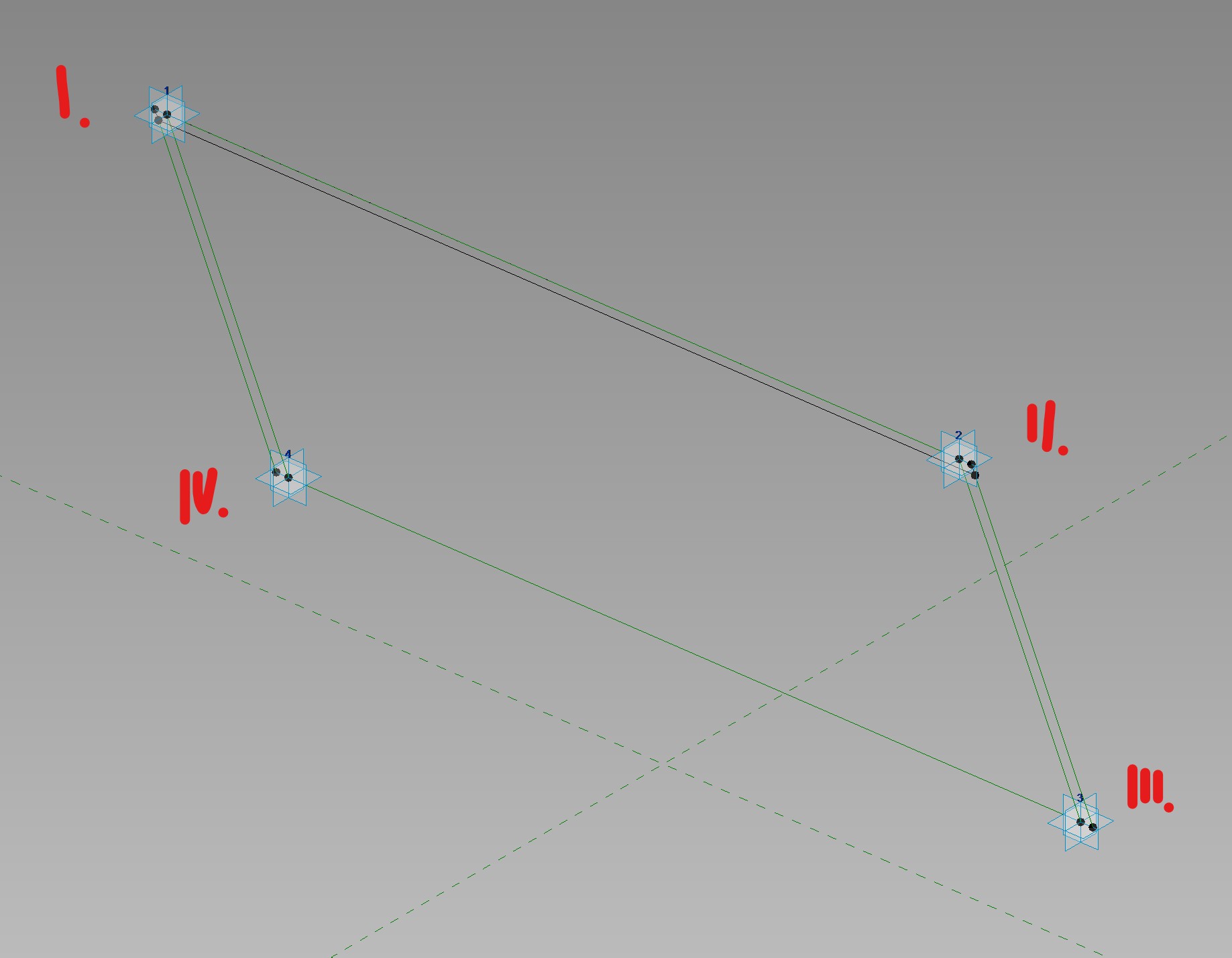

I have an adaptive family with 4 adaptive points, and I would like to constrain or attach each point to an axis. Is there a way to perform this action ?
Hi BigB,
in the superstructure command, you are allowed to use only 1 adaptive point. To achieve your goal, please change the propertiy of adaptive point II, III and IV to a shape handle point. These shape handle points can be connected to any other axis or secondary axis. The superstructure is connected to on guiding axis via the on adaptive point.
