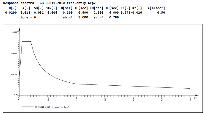

This is the RS definition
| LC | NO | TYPE | TITL | |
| 600 | NONE | RESP | ||
| RESP | TYPE | CLAS | MOD | |
| GBF2 | II | 0.02 |
and this is result in report
