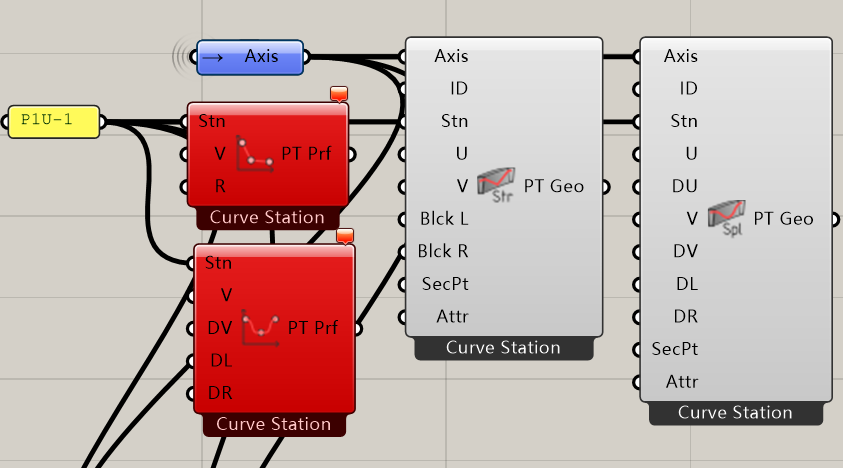

Enable “placment” for statioin in "PT Profile | Polygon" and "PT Profile | Spline"
In grasshopper, the station input of “PT Geometry | Straight” and “PT Geometry | Spline” accept placement (P1U-1 in this case), while “PT Profile | Polygon” and
“PT Profile | Spline” don’t accept placement as input, they only accept digits. But placement is very useful in some cases, it it possible to enable both placement and digits for station in “PT Profile | Polygon” and “PT Profile | Spline”?
Hi there!
Thanks for turning our attention to this. We will investigate this further and get back to you when have some conclusions.
Regards,
Wojciech from SOFiSTiK
