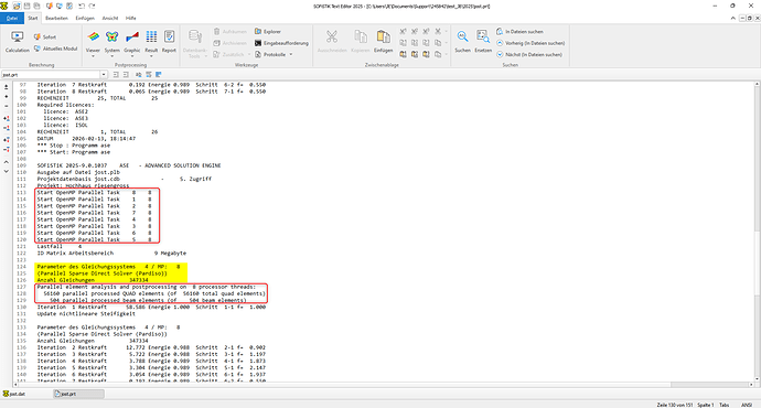

The ELLA task is not parallelized; it is a sequential process. However, how these processes are distributed across individual threads depends on the hardware configuration and on how the operating system handles them.
If a module can perform tasks in parallel, you will find a corresponding note in the WPS (Windows Program Start = calculation window), see the lines marked in red in 01a. The lines marked in yellow refer to the solution of the stiffness matrix, which is only used in modules such as TALPA, ASE, or DYNA (STEU SOLV 4).
